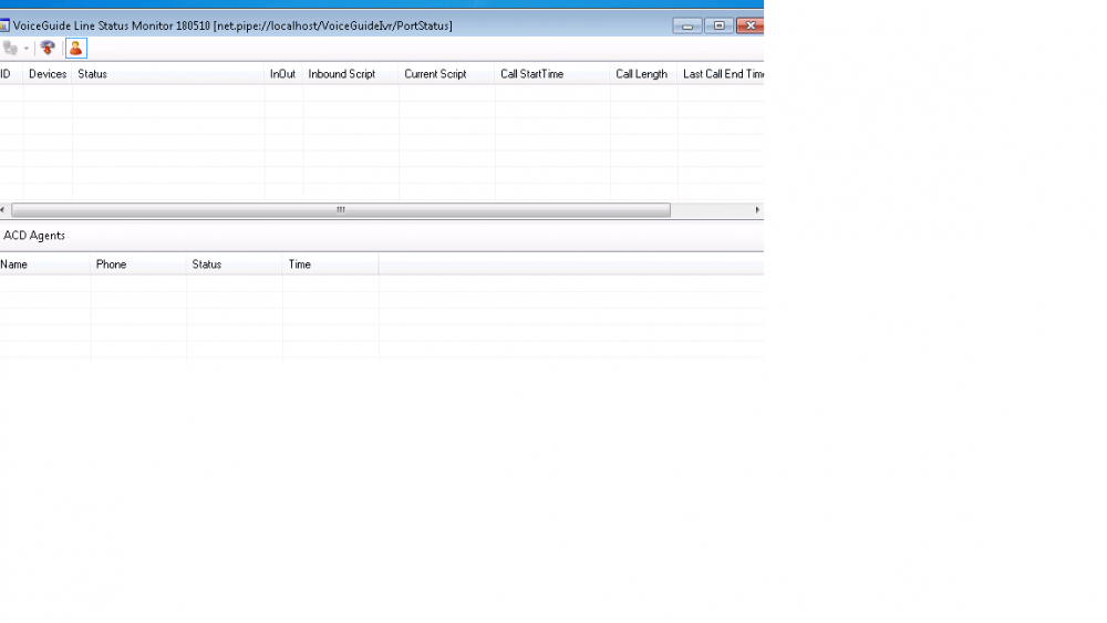

this is my simplest script. I put it here
Xml disappears but it calls nowhere
Please help me to test dialer out
Please .ZIP up the contents of VoiceGuide's \log\ subdirectory and post it here.
We can then see what is happening on the system and advise.

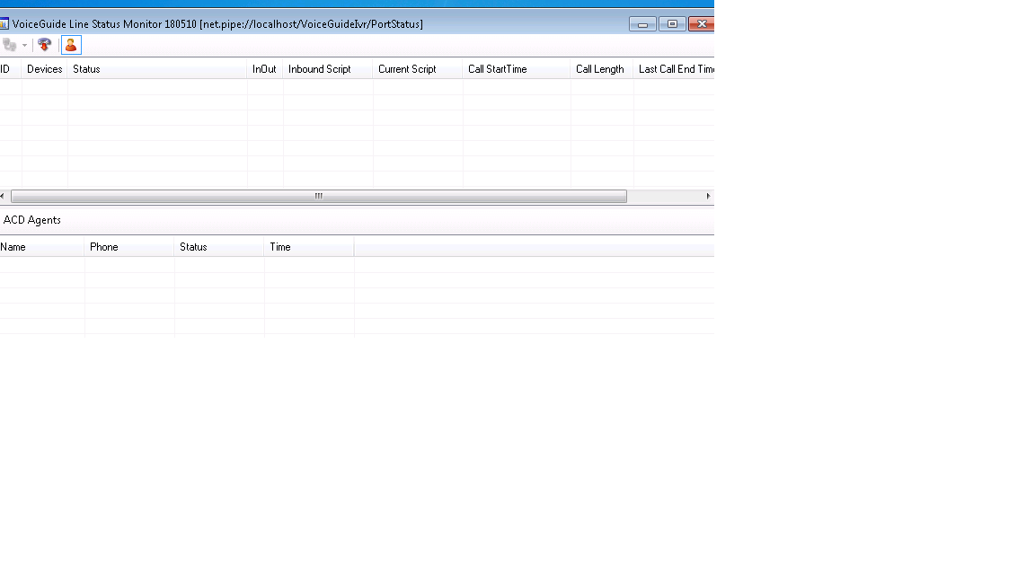

I have an issue with dialout
I made a list with only 1 person myself
Made that XML format put in Data folder.
It disappeared but no dialing out happened

First of all, the VoiceGuide software was installed in VoIP mode, instead of in "Dialogic card" mode.
We can take you though the configuration changes required to fix this, but it's easiest if you could just do this:
1. Stop VoiceGuide service
2. Exit all VoiceGuide programs
3. Uninstall VoiceGuide and then manually delete the entire VoiceGuide directory tree.
4. Restart PC
5. Install VoiceGuide again, and this time make sure to select the "Telephone lines / Dialogic cards" option during setup, not VoIP.
Please see: https://www.voiceguide.com/vghelp/source/html/install_v7_dialogicsr60.htm
After software is re-installed and service started please try calling into the system to make sure the phone lines are working.
Once you confirmed the system ins answering incoming calls then try loading the outgoing call.
If you encounter any issues please post traces as before.
