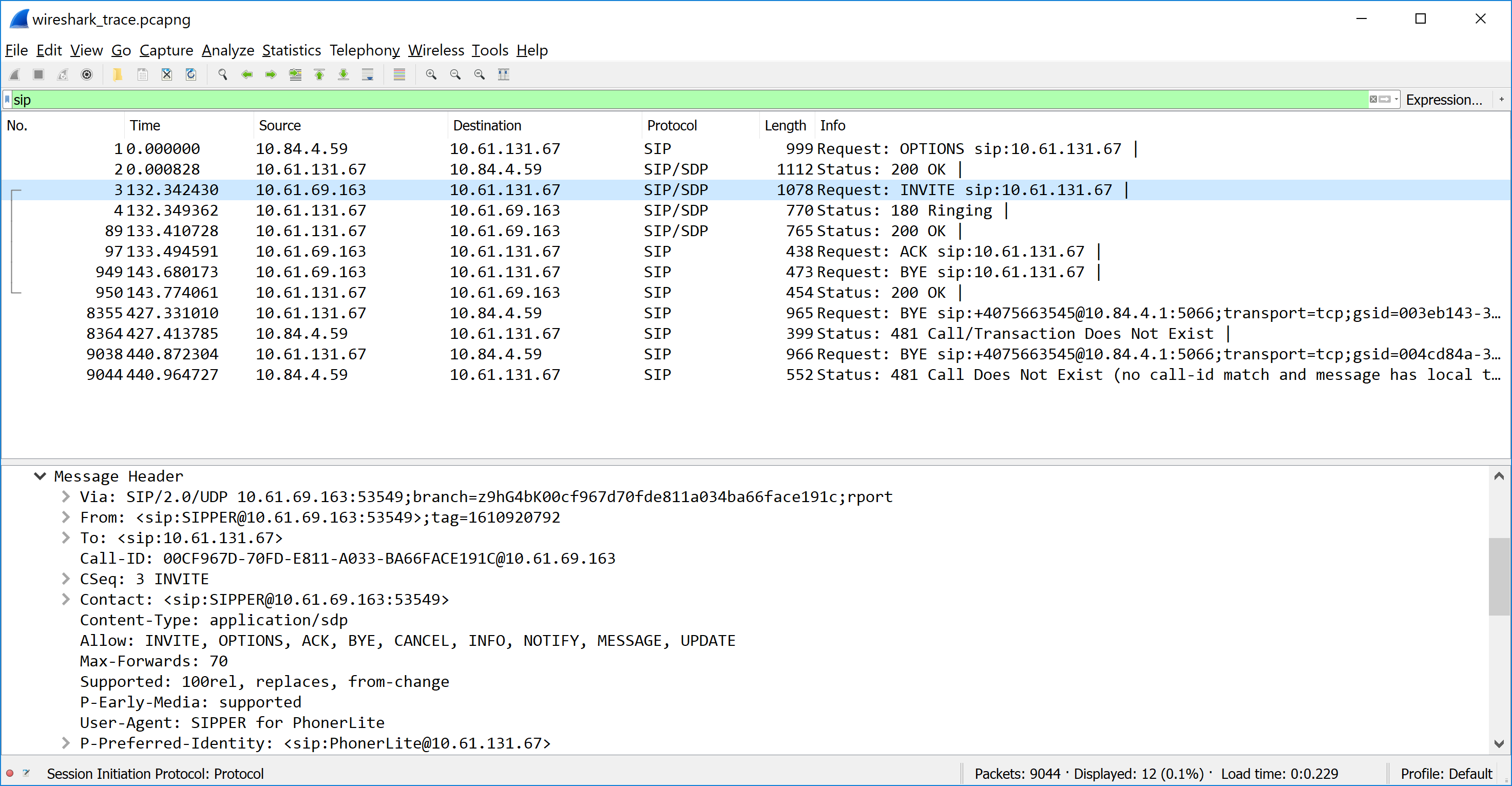

lucasklos Report post Posted 12/14/2018 11:20 AM Hi Support Team, We are having a problem in one site we have voiceguide + hmp running. It is Voiceguide 7.4 + HMP on Windows Server 2008R2. Calling from a softphone works perfectly, bug when calling from a fixed phone, through a SIP trunk created in Avaya PBX the calls get accepted (I can see the call arriving using the Line Status Monitor) but never gets answered. Currently my script has "StartWithoutAnswer=1" but I tested changed this value to 0 and the same happens. Also, I tested with voiceguide 7.5, same results. I'm attaching to this post wireshark traces, voiceguide log and HMP Rtf logs. Could you please take a look and let me know? hmp_rtflog.txt voiceguide_log.txt wireshark_trace.pcapng Share this post Link to post

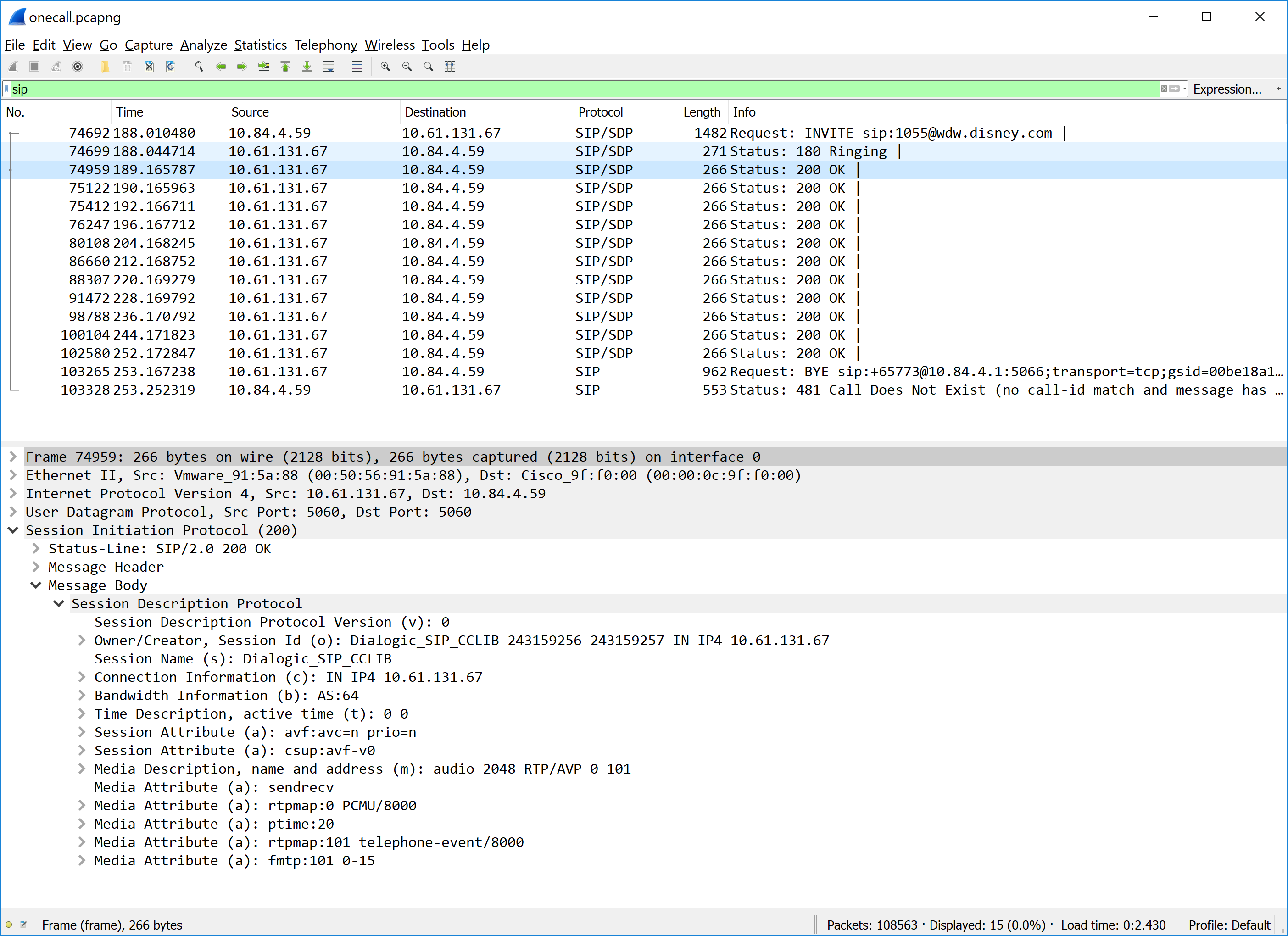

SupportTeam Report post Posted 12/17/2018 06:01 PM WireShark Trace shows HMP was sending OK response advising it wants to answer the call, but the PBX never sent back an acknowledgement (ACK) that it received the OK. This is why HMP can be seen re-sending OK multiple times. HMP is waiting for an ACK from PBX before it will consider call as being acknowledged as answered and the proceed with call. WireShark screenshot attached. You should confirm whether the Avaya is sending out an ACK or not. This can be done by capturing a trace of network traffic at Avaya's network interface. If Avaya is sending out an ACK then it looks like you have a network connectivity issue. Here is a one article that describes what you could be experiencing: https://blog.opensips.org/2017/02/22/troubleshooting-missing-ack-in-sip/ Share this post Link to post
