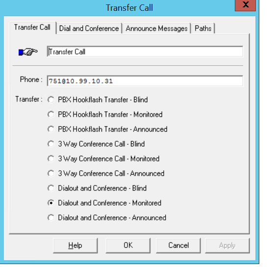

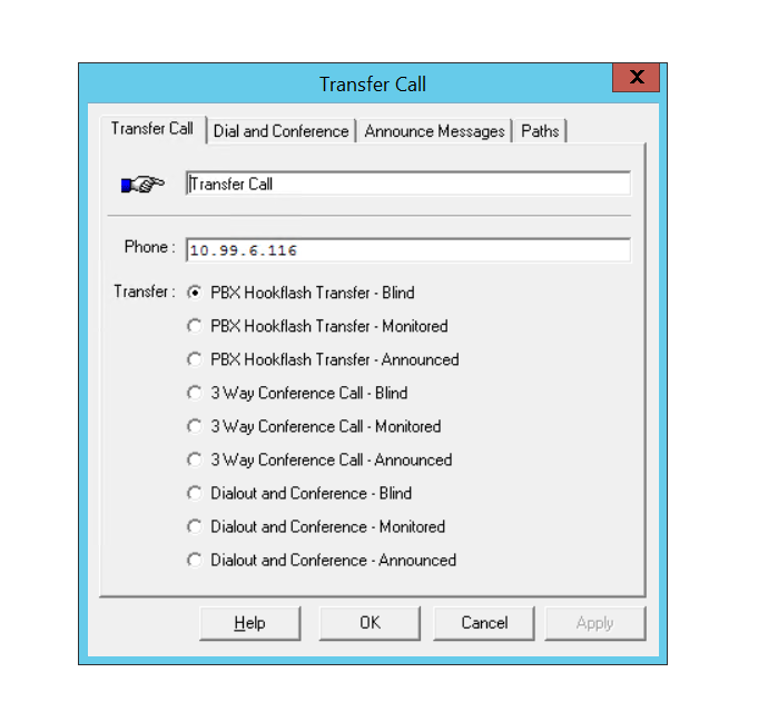

Guest mohammedzoheb Report post Posted 12/26/2018 07:08 AM Hi i am using Transfer to call please check the below image and logs.When press 1 call is hanging up not able to transfer please let me know how could i use transfer to call as i am using SIP Trunk. WireSharkLog.pcapng 1226_CallEvents.txt Share this post Link to post

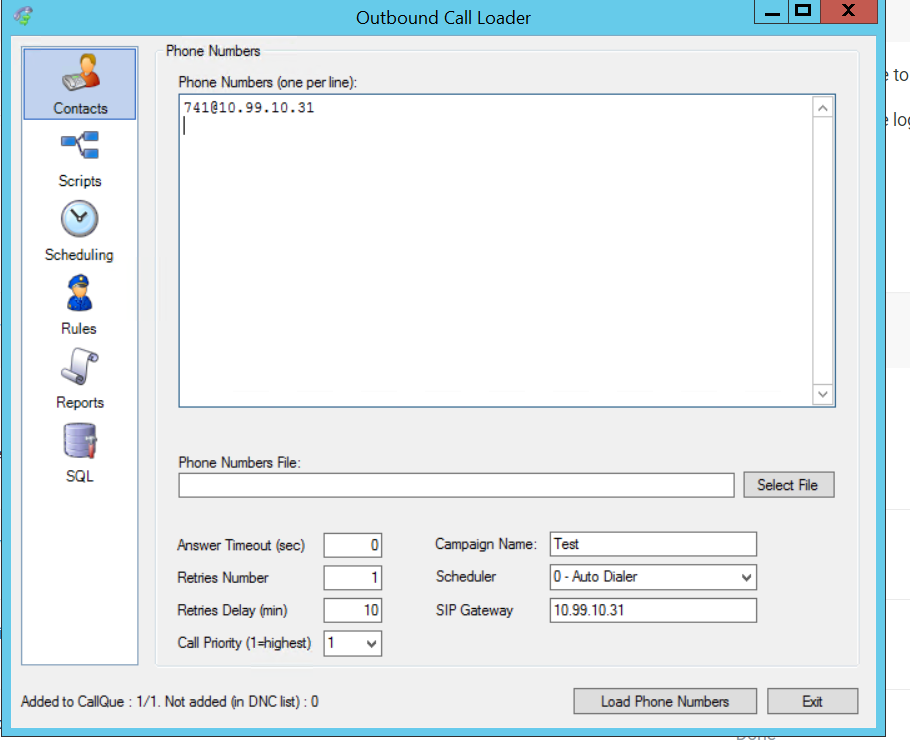

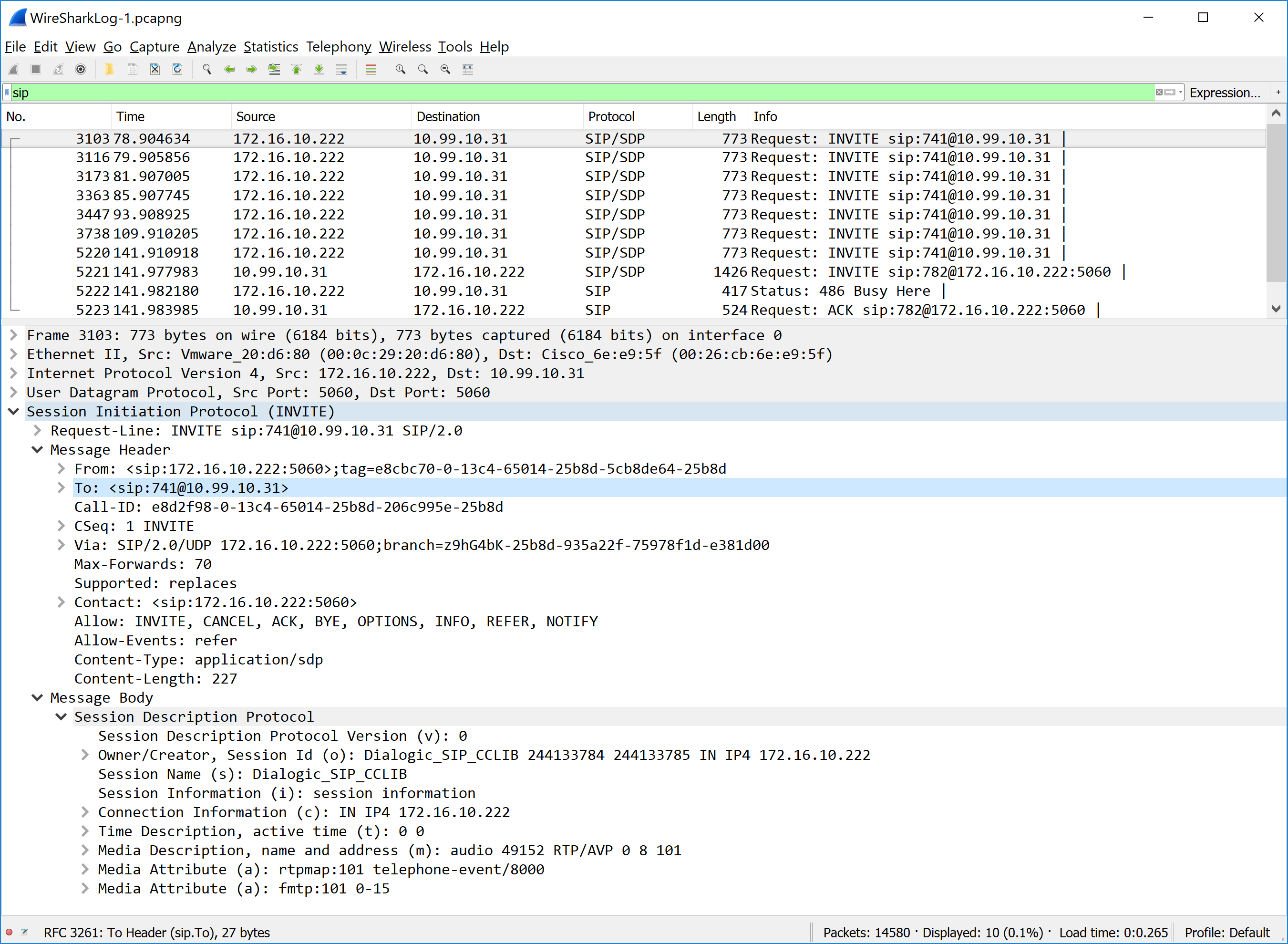

Guest mohammedzoheb Report post Posted 12/26/2018 07:38 AM I am using Outbound Call Loader wireshark logs show that its calling to my number but i am not receiving a call please check . WireSharkLog.pcapng 1226_CallEvents.txt Share this post Link to post
SupportTeam Report post Posted 12/26/2018 01:39 PM On SIP Trunks you will usually need to use the "Dialout and Conference" type transfers. Regarding the outgoing calls: WireShark shows that the outgoing INVITE sip messages are sent out, but there is no response of any kind from 10.99.10.31 Suggest checking logs on the 10.99.10.31 device side to see how the arriving SIP invite messages were processed by 10.99.10.31 Share this post Link to post
Guest mohammedzoheb Report post Posted 12/26/2018 01:54 PM On 12/26/2018 at 1:39 PM, SupportTeam said: Suggest checking logs on the 10.99.10.31 device side to see how the arriving SIP invite messages were processed by 10.99.10.31 you mean i should check with Cisco Call Manager or can you elaborate please Share this post Link to post
Guest mohammedzoheb Report post Posted 12/26/2018 02:00 PM On 12/26/2018 at 1:39 PM, SupportTeam said: On SIP Trunks you will usually need to use the "Dialout and Conference" type transfers. Request you to provide any documentation regarding this and also is there any configuration needs to be done in config file let me know Share this post Link to post
SupportTeam Report post Posted 12/26/2018 02:16 PM Quote you mean i should check with Cisco Call Manager Yes. SIP INVITE was sent to Cisco Call Manager, but there was no reply from CUCM. No special configuration needed, as you are receiving the calls from that SIP trunk into VoiceGuide, as per posts in other thread. (you are still receiving calls from that CUCM into VoiceGuide, right?) Share this post Link to post

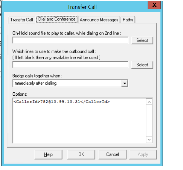

Guest mohammedzoheb Report post Posted 12/26/2018 02:23 PM Hi Please check the call event and steps as i am using sip trunk you ask to use Dialout and Conference but after following the step not able to transfer please check the log 1226_CallEvents.txt 1226_vgService.txt Share this post Link to post
SupportTeam Report post Posted 12/26/2018 02:48 PM The "Dial and Conference" uses another line to place the outgoing call. Right now your test system only had one HMP line, and it is used by the incoming call. This is why you see this message in VoiceGuide logs: "No free line for 2nd leg of call" You can obtain a temporary 2 line HMP license from here: https://www.dialogic.com/hmp-software/hmp-license Once you have a 2 line license you can attempt the "Dial and Conference" transfers. Recommend confirming that normal outbound calls work first. You can test outbound calls with your current 1-line license. The second leg of the "Dial and Conference" transfer call is an outgoing call. You may need to set the <CallerId> option on the outgoing calls, but this is usually only required if the PBX needs to authenticate outgoing calls made though the SIP trunk first. CallEvent log shows: { "call": { "crn": "8000001", "port": "1", "direction": "in", "time_start": "2018-12-26 17:15:23", "events": " 171523.186|callstate|GCEV_OFFERED|741@10.99.10.31||782@172.16.10.222|[SIP_HDR_Request_URI]{sip:782@172.16.10.222:5060}[SIP_HDR_Contact_URI]{sip:741@10.99.10.31:5060}[SIP_HDR_FROM_DISPLAY]{"zohebuddin"}[SIP_HDR_EXPIRES]{180}[SIP_HDR_CALLID]{f23e7080-c2318d6e-879fd-1f0a630a@10.99.10.31}[SIP_HDR_FROM]{"zohebuddin"<sip:741@10.99.10.31>;tag=3440826~4c075c6d-5a3b-4906-9ab9-f8e1d805b877-29066501}[SIP_HDR_TO]{<sip:782@172.16.10.222>}[SIP_Header_Via]{SIP/2.0/UDP 10.99.10.31:5060;branch=z9hG4bK9356b52fc0ef1}[SIP_Header_From]{"zohebuddin"<sip:741@10.99.10.31>;tag=3440826~4c075c6d-5a3b-4906-9ab9-f8e1d805b877-29066501}[SIP_Header_To]{<sip:782@172.16.10.222>}[SIP_Header_Contact]{<sip:741@10.99.10.31:5060>;+u.sip!devicename.ccm.cisco.com="SEPB4A8B9E85EF3"}[SIP_Header_Call-ID]{f23e7080-c2318d6e-879fd-1f0a630a@10.99.10.31}[SIP_Header_User-Agent]{Cisco-CUCM11.5}||0|2|8|0 171523.187|event|GCEV_OFFERED|741@10.99.10.31||782@172.16.10.222|[SIP_HDR_Request_URI]{sip:782@172.16.10.222:5060}[SIP_HDR_Contact_URI]{sip:741@10.99.10.31:5060}[SIP_HDR_FROM_DISPLAY]{"zohebuddin"}[SIP_HDR_EXPIRES]{180}[SIP_HDR_CALLID]{f23e7080-c2318d6e-879fd-1f0a630a@10.99.10.31}[SIP_HDR_FROM]{"zohebuddin"<sip:741@10.99.10.31>;tag=3440826~4c075c6d-5a3b-4906-9ab9-f8e1d805b877-29066501}[SIP_HDR_TO]{<sip:782@172.16.10.222>}[SIP_Header_Via]{SIP/2.0/UDP 10.99.10.31:5060;branch=z9hG4bK9356b52fc0ef1}[SIP_Header_From]{"zohebuddin"<sip:741@10.99.10.31>;tag=3440826~4c075c6d-5a3b-4906-9ab9-f8e1d805b877-29066501}[SIP_Header_To]{<sip:782@172.16.10.222>}[SIP_Header_Contact]{<sip:741@10.99.10.31:5060>;+u.sip!devicename.ccm.cisco.com="SEPB4A8B9E85EF3"}[SIP_Header_Call-ID]{f23e7080-c2318d6e-879fd-1f0a630a@10.99.10.31}[SIP_Header_User-Agent]{Cisco-CUCM11.5}||2|0|8|0 171523.187|command|cmd_AnswerCall|||||0|0|0|0 171523.256|event|GCEV_ANSWERED|||||2050|0|0|0 171523.256|callstate|GCEV_ANSWERED|||||0|256|4|0 171523.257|state|[Welcome] Playing wav (C:\zoheb\Eng2.wav)|||||0|0|0|0 171523.257|event|GCEV_ANSWERED|||||256|1|4|0 171526.833|state|[Web Service 8] Web Service|||||0|0|0|0 171526.834|command|cmd_PlayStop|||||0|0|0|0 171526.834|dtmf||1||||49|0|0|0 171527.574|state|[CustomerService] Playing wav (C:\zoheb\CustomerService.wav)|||||0|0|0|0 171528.848|state|[Transfer Call] Monitored Dial and Connect to 751@10.99.10.31|||||0|0|0|0 171528.850|state|Hanging up... [No free line for 2nd leg of call]|||||0|0|0|0 171528.852|command|cmd_DropCall|||||0|0|0|0 171528.876|callstate|GCEV_DROPCALL|||||0|1|32|0 171528.891|event|GCEV_DROPCALL|||||1|0|32|0 171528.908|callstate|GCEV_RELEASECALL|GCST_NULL||||2137|0|0|0 ", "length": "5.722" }}, Share this post Link to post

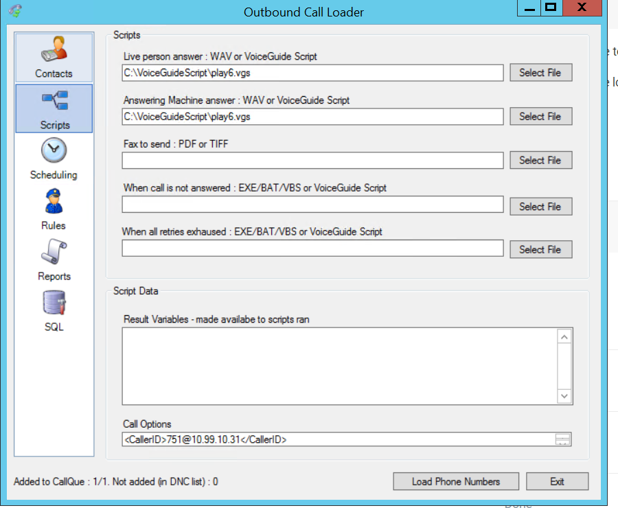

Guest mohammedzoheb Report post Posted 12/27/2018 09:48 AM Please check is there any configuration changes needs to done because some calls i am able to call using Outbound IVR but sometimes its not able to call. Also i configure the script when the call is answer by live person but after answering the call after 30 to 40 sec my script is playing please check the log . 1227_CallEvents.txt 1227_1223_vgDialListLoad.txt 1227_vgService.txt 1227_ktTel.txt WireSharkLog.pcapng Share this post Link to post
SupportTeam Report post Posted 12/27/2018 11:46 AM The last 3 outgoing calls in the logs were all successful, but it looks like you have the specified a script in both the "Live Person Answer" and the "Answering Machine Answer" fields, so the system is trying to determine what answered the call and start the appropriate script. To determine what answered the call the system waits to hear what is said/played by the side that answered the call. It looks like on the last 3 calls nothing was said by the party answering the call, and the system is just waiting to hear something. That is why you wait o long until system eventually tomes out and starts playing the default "Live Person / Human" script. When answering calls please say "Hello" or similar, like normal calls would be answered. You should then see system detect answer type and start script. You can also set the "Answering Machine Answer" field to: disable This way the "Live Person Answer" script will be started immediately when the call is "picked up", without waiting for call recipient to say anything. Please also see: https://www.voiceguide.com/vghelp/source/html/detectcallanswer.htm 122700.958|command|MakeCall_Completed|741@10.99.10.31|751@10.99.10.31||<result>ok</result><crn>134217729</crn><crnx>8000001</crnx>|0|0|0|0 122706.735|callstate|GCEV_CONNECTED|||||0|256|4|0 122706.741|state|Dialing (auto) 741@10.99.10.31 ..., doing answer detection... (DX_PAMDOPTEN)|||||0|0|0|0 122746.767|state|Human answer. Start [C:\VoiceGuideScript\play6.vgs]|||||0|0|0|0 122746.775|state|[Welcome] Playing wav (C:\zoheb\Eng2.wav)|||||0|0|0|0 123000.969|command|MakeCall_Completed|741@10.99.10.31|751@10.99.10.31||<result>ok</result><crn>134217729</crn><crnx>8000001</crnx>|0|0|0|0 123004.066|callstate|GCEV_CONNECTED|||||0|256|4|0 123004.068|state|Dialing (auto) 741@10.99.10.31 ..., doing answer detection... (DX_PAMDOPTEN)|||||0|0|0|0 123044.094|state|Human answer. Start [C:\VoiceGuideScript\play6.vgs]|||||0|0|0|0 123044.096|state|[Welcome] Playing wav (C:\zoheb\Eng2.wav)|||||0|0|0|0 122700.958|command|MakeCall_Completed|741@10.99.10.31|751@10.99.10.31||<result>ok</result><crn>134217729</crn><crnx>8000001</crnx>|0|0|0|0 122706.735|callstate|GCEV_CONNECTED|||||0|256|4|0 122706.741|state|Dialing (auto) 741@10.99.10.31 ..., doing answer detection... (DX_PAMDOPTEN)|||||0|0|0|0 122746.767|state|Human answer. Start [C:\VoiceGuideScript\play6.vgs]|||||0|0|0|0 122746.775|state|[Welcome] Playing wav (C:\zoheb\Eng2.wav)|||||0|0|0|0 Share this post Link to post
Guest mohammedzoheb Report post Posted 12/27/2018 11:56 AM On 12/27/2018 at 11:46 AM, SupportTeam said: You can also set the "Answering Machine Answer" field to: disable yes i followed this now its working fine thanks for your support. Share this post Link to post
