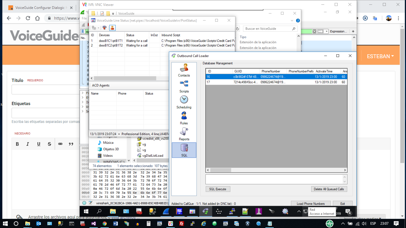

Screenshot shows that you only have the "Professional" version of the license.
To make outgoing calls you will need the "Dialer" license.
You will need to upgrade your license to "Professional+Dialer" (or to "Enterprise+Dialer) to be able to make outgoing calls when running in licensed mode.
The Evaluation version lets you make a few outgoing calls, that is why it works before applying the license.
