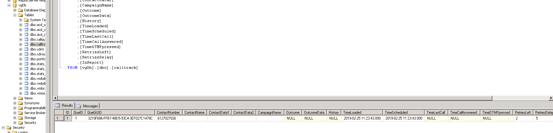

George G Report post Posted 02/25/2019 05:38 PM Below I attach latest trace and the snip of calltrak table my call sits there but does not dial. Whta happens is that it goes to calltrack table not in callque. Look at the ENGINE trace it says nowhere to call. calls land into calltrak not in callque and in looks call que which is empty. Very strange connection string is good since calltrak table gets populated . 0225_1122_vgEngine.zip Share this post Link to post
