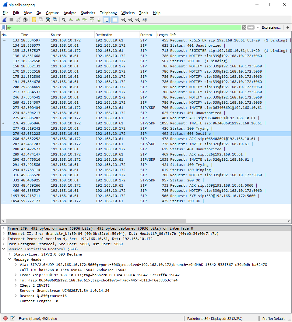

WireShark trace shows that VoiceGuide registered itself successfully as extension 339 with PBX/Switch at 192.168.10.61
At timestamp '42.5" VoiceGuide made an outgoing call to 063408691@192.168.10.61, but the PBX/Switch at 192.168.10.61 declined the call.
192.168.10.61 advised "Q.850 cause 16" as reason for declining the call, which is just a normal clearing code.
You should look into 192.168.10.61's logs (192.168.10.61 looks to be a Grandstream UCM6208 IP PBX Appliance) to determine why it returned this response.
Grandstream first advised that it is "Trying", and then about 100ms later advised that the call wasDeclined, so most likely it did try placing an outgoing leg of the call to 063408691, but that outgoing call attempt failed, and as a result the Grandstream had to return the "Decline" message to VoiceGuide.
The second call made was to extension 326, and it was successful, with Grandstream advising that call was connected/answered about 5 seconds later.
The second call had a script specified for both live answer and answering machine, so the HMP started listening to the line to determine what answered the call, but looks it could not determine what answered the call and the call recipient hung up after 10 seconds.
