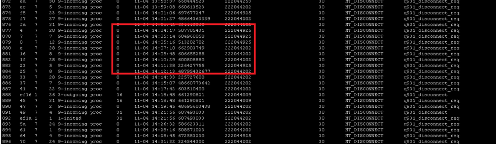

we have a problem with 1 serwer the calls are sometimes rejected with cause 0. In log of VG are no trace.
After restarting VG, connections will be accepted for some time
What device/system is this trace from?
Does this trace show on which E1 ISDN trunk and which channels of that trunk the call was attempted to be sent ?
Can you also please post ktTel trace for that day. Please .ZIP up any traces before posting.
The device is Dinstar MTG2000 in the 3rd column is port to which connected the serwer VG. In the 4th column is the port number to which the connection entered
