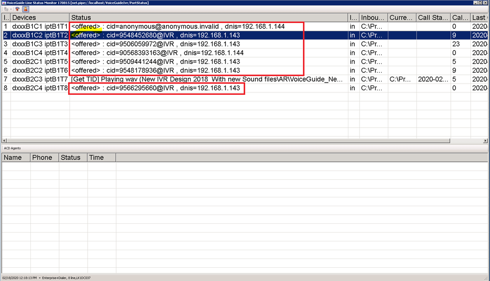

ahmed.muneer Report post Posted 02/20/2020 12:23 PM Dear VG Team, I noticed recently in the Line status monitor i found some line lines turns into <Offered> status which is will cause the line to don't accept any call and it will be like this always unless i go and click on that line then cli ck on Hangup Line icon after that it will turn into "Waiting for call" , please advise since this issue causing a lot of problem for our operations , that attached screen shot is FYR. Share this post Link to post

SupportTeam Report post Posted 02/25/2020 10:59 AM ktTel traces provided (for Feg-15 to Feb-23) show that calls continued to be handled by system during those 9 days, with hundreds of calls answered and handled each day. The timestamp on the Line Status Monitor suggests that the screenshot was taken on 18th Feb at 12:18PM. Is that the time when screenshot was taken? The logs for 4 days before that time, (15th, 16th, 17th and 18th Feb) do not show any records for any of 6 CallerID numbers showing on that screenshot, but show ongoing activity on those channels. So perhaps this Line Status Monitor got 'stuck' in some way on the 'offering' state some time before 15th Feb on those lines, and was no longer showing actual activity. Do you know when the call from "9548452680@IVR" arrived at the system? Can you post the ktTel and vgEngine traces from that day? (or for any of the other 5 Caller-IDs displayed on screenshot). The VoiceGuide database has statistical information that also lets you see how many calls were handled by each port during each 30 minutes of operation, so you can view those details to quickly confirm how active each port was (note that on HMP system s the calls are delivered by HMP to 'first-available' port). CDR logs can also be used to confirm calls and what ports they arrived on. Searches though ktTel or vgEngine log files let you also confirm this, but that process takes longer. To resolve we would recommend updating system to latest versions of VoiceGuide and HMP and seeing if Line Status Monitor in the newest VoiceGuide version encounters similar issues on your system. If it does we can then try to replicate on our test systems in-house. Share this post Link to post

SupportTeam Report post Posted 03/05/2020 09:34 AM Looks like this version has an issue with not correctly handling a case when the outgoing leg of the 'dial and conference' call transfer recieved a 'Disconnected' event immediately after dialing. (ie. the number that the call was being transferred to does not exist). This then led to the issues that you are seeing. Please update system to latest version of VoiceGuide. In the latest version of VoiceGuide this issue has been resolved. As your your system is currently running an older v7.5 you will need to contact sales@voiceguide.com to obtain a new license code for the current v7.6 version. Share this post Link to post
