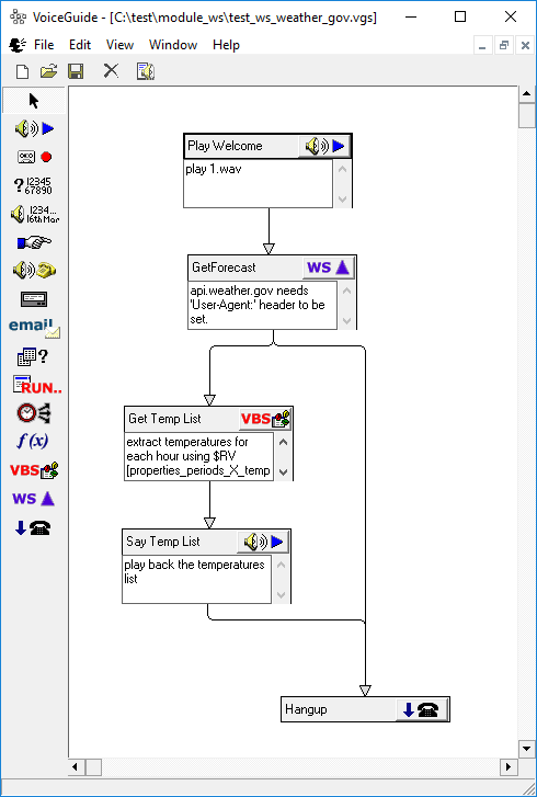

A short demo VoiceGuide script was created which uses a Web Service module to retrieve a 7 day 'hourly' weather forecast from weather.gov provided web service. The following "Run Script" module then extracts the temperatures from returned data and puts them in a comma separated list. TTS is then used to read out the temperature list.
The VoiceGuide Script looks like this:

The above returned data creates $RVs which then allow individual entries from returned JSON to be accessed from other modules in script.
The module "Get Temp List" uses this VBScript to access all the temperatures and put them in a list:

The list of temperatures is stored by above script in $RV[AllFieldNameEntries] and is then read out using TTS in the "Say Temp List" module.
Google Cloud was used as TTS engine in this example, and it completed returning  the 2 minute long .WAV file back in 3 seconds:
