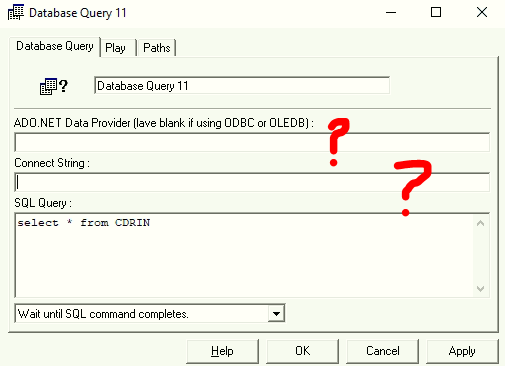

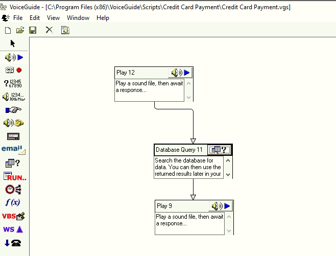

Hello I have a client that I need to migrate from 7.4 to 7.6.
but before it is necessary to make a query to an Oracle database.
in 7.4 and 7.6 give me the same error, I thought it was the version that was updated. but no.
try all these kinds of connections without result
Driver={Oracle in OraClient11g_home2};Server=10.129.180.8;Dbq=DBHVQ;Uid=callcenter;Pwd=call;
Driver={Oracle in OraClient11g_home2};Dbq=DBHVQ;Uid=callcenter;Pwd=call;
ODBC;Driver={Oracle in OraClient11g_home2};SERVER=[10.129.180.8];UID=[callcenter];PWD=[call];DBQ=[DBHVQ];
Driver={Oracle in OraClient11g_home2};Server=DBHVQ;Uid=callcenter;Pwd=call;
Driver={Oracle in OraClient11g_home2};Dbq=dbhvq.quito.hcjb.org;Uid=callcenter;Pwd=call;
DSN=DBHVQ;
Please your help, br
Diego

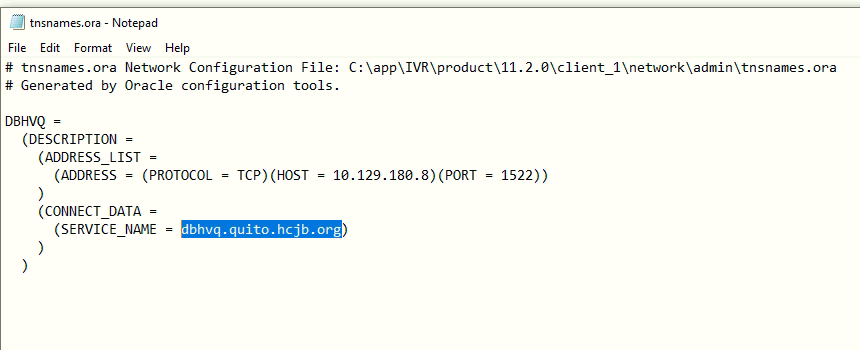

Oracle.DataAccess.Client, (DESCRIPTION=(ADDRESS=(PROTOCOL=TCP)(HOST=10.129.180.8)(PORT=1522))(CONNECT_DATA=(SERVER=DEDICATED)(SERVICE_NAME=dbhvq.quito.hcjb.org))), Provider=Oracle.DataAccess.Client,
ConnectAndRun_AdoNetFactory : '(DESCRIPTION' is an invalid connection string attribute

On thing of note is that the VoiceGuide Dialer was able to connect to the Oracle database using the ADO.NET Oracle.DataAccess.Client provider.
So suggest looking at VoiceGuide's Config.xml and the OutDialQue_ConnectString parameter. Same connection approach should work when used in a Database Query module.
143249.200   9                     db    config OutDialQue_ADODB_Provider = Oracle.DataAccess.Client
143249.200   9                     db    config OutDialQue_Database = dbhvq.quito.hcjb.org
143249.200   9                     db    config OutDialQue_ConnectString.len = 171
As the ADO.NET Oracle.DataAccess.Client approach works the suggest you use ADO.NET connection method instead of ODBC in the Database Query module.

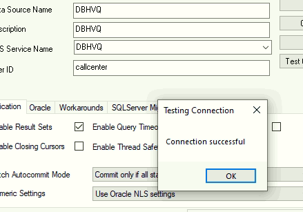

It looks like there are many possible reasons why Oracle returns the "ORA-12154: TNS:could not resolve the connect identifier specified" error.
It's an error from Oracle so maybe Oracle support can shed more light why this error is returned in your case and what changes in Oracle's own configuration are needed for it to not return that error. No idea why the test of connection from the "Oracle ODBC Driver Configuration" app would return "Connection Successful", when attempts to use that ODBC connection return ORA-12154. Maybe there are some traces generated by Oracle that would shed more light on cause.
Searching for above error on internet brings up many hits.

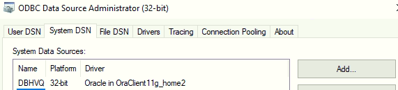

Would recommend ensuring that only 32-bit Oracle clients are installed on system, and remove all 64-bit versions, and remove the ODBC DSN entries from the 64-bit ODBC Data Source Administrator.
Otherwise it looks like you have to reconfirm that the compatible versions of drivers are used and that Oracle configuration files and System-wide Environment Variables etc. are all correctly set in order for Oracles ODBC drivers to establish this connection.
