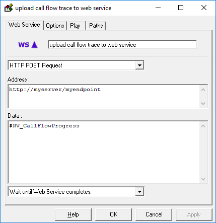

In VoiceGuide v7.6.27 onward the events log entry that was quoted beforehand will be accessible in-script using this Result Variable:
$RV_CallFlowProgress
You will then be able to upload that information to a http/https service by using a Web Service module, like this:
To upload the full log including the events capturing end of call, that web service module should be used in the "After Hangup" callflow - the VoiceGuide script that is ran after the call ends.

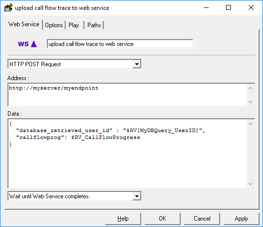

You can include any other data in Web Service modules (JSON or otherwise) as well.
eg: you can do something like this:
You can probably just use the Result Variables created by each module and save/post those using a Web Service module after each of the modules that you need to record actions of.
