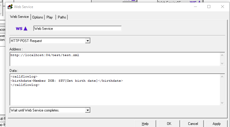

I would like to ask that why I can't post data via web service module ? Although the callflow can connect web service successfully, the data can't write in xml file. Please refer to the attachment. Does the web service post data only support xml ? Thank you.

The HTTP address is incorrect.
The screenshot shows that address is specified as:
http://localhost:84/test/test.xml
That is not a valid HTTP Service address.
Please check what is the HTTP Service's address endpoint, amend accordingly, and try again.
If you are still encountering problems please post the vgEngine trace that captures the call and the execution of the "Web Service" module in particular.
Are you trying to do a HTTP POST, or are you trying to read in the "test.xml" file?
To read in the "test.xml" file you should be using a "HTTP GET" request.
Thank you. I am trying to do a HTTP POST. I want to insert web service data in test.xml
You want the webservice to place the data posted to it into a file (test.xml) on the machine running the web service?
This is something that would be done by whatever is running the "test" endpoint webservice on port 84...
Yes, I want to to place the data posted to it into a file (test.xml) on the machine running the web service, but I can't do it.
Do you actually want to send data to a web service running on another machine/server, or do you just want to save data to a file on a local machine?
You seem to want to connect to a web service running on a local machine, and then have that web service save to file, so why not just save to file directly from VoiceGuide?
Example of how to save to file can be found here:
https://www.voiceguide.com/vghelp/source/html/modvbs.htm
see the "Example : Save to File" section in the above link.
