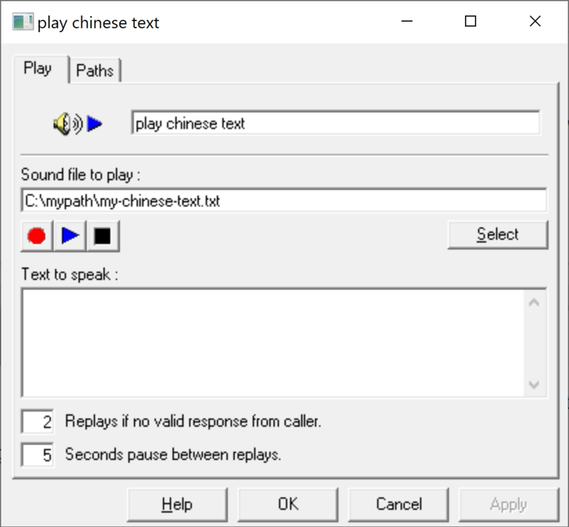

You can specify a text file (.txt) as the 'sound file to play'. Like this:
The contents of the .txt file will then be played out using the selected Text-to-Speech engine.
All characters in the .txt file will be passed to the TTS engine.
The current Script Designer only allows ASCII/Latin characters in the "Text to Speak" text box. Using the .txt file is the current workaround that limitation.

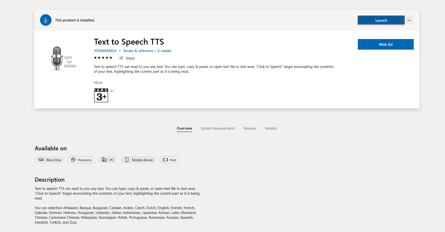

Thank you. However, when I run the script, it can't not say Cantonese. Do I need to install any software?
Thank you. I have just install a Cantonese TTS engine . How do I config with  VoiceGuide . Please refer to the attachment.
