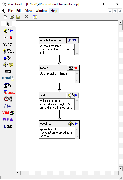

Here is a simple script demonstrating transcription of recorded sound file.
VoiceGuide Script file:
record_and_transcribe.vgs
The script enables transcription and starts recording of a sound file. When the recording completes (on silence detection) the recorded sound file is then transcribed, and the result of transcription  is played back to the caller.
