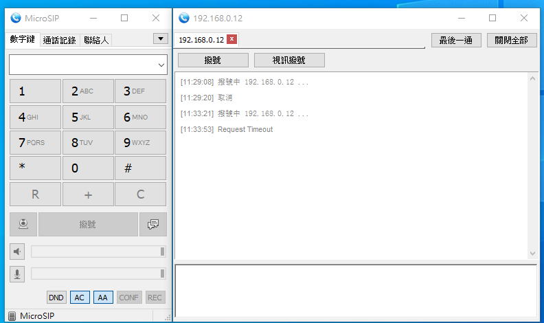

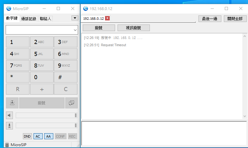

Ada Report post Posted 07/16/2020 03:50 AM Thank you. But when I used MicroSIP to test the script. It has problems. Please refer to the attachment. 0716_1132_vgEngine.zip Share this post Link to post
SupportTeam Report post Posted 07/16/2020 07:15 AM This question is the same as your previous thread here: https://www.voiceguide.com/forums/topic/13203-cant-test-voiceguide-script/ We are going to merger the two threads together. Share this post Link to post
SupportTeam Report post Posted 07/16/2020 07:19 AM You are trying to call an analog system from a VoIP softphone using an IP address? Is the "192.168.0.12" IP address the address of a VoIp<->Analog media gateway? You should have a good look at your networking and media gateways etc. setup... Share this post Link to post
