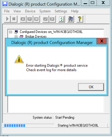

Voice Guide not working after restarting the server
Traces show that the Dialogic HMP channels cannot be opened:
170938.222   8              ERROR LineOpen failed for iIvrDev=1,
Suggest stopping both VoiceGuide and Dialogic services, and then just starting the Dialogic service, confirm that it starts up OK, and then start the VoiceGuide service afterwards.
Is this an VMWare ESXi based system? Is this system connected up to a vCenter Server?
Dear Support,
  • VMWare System

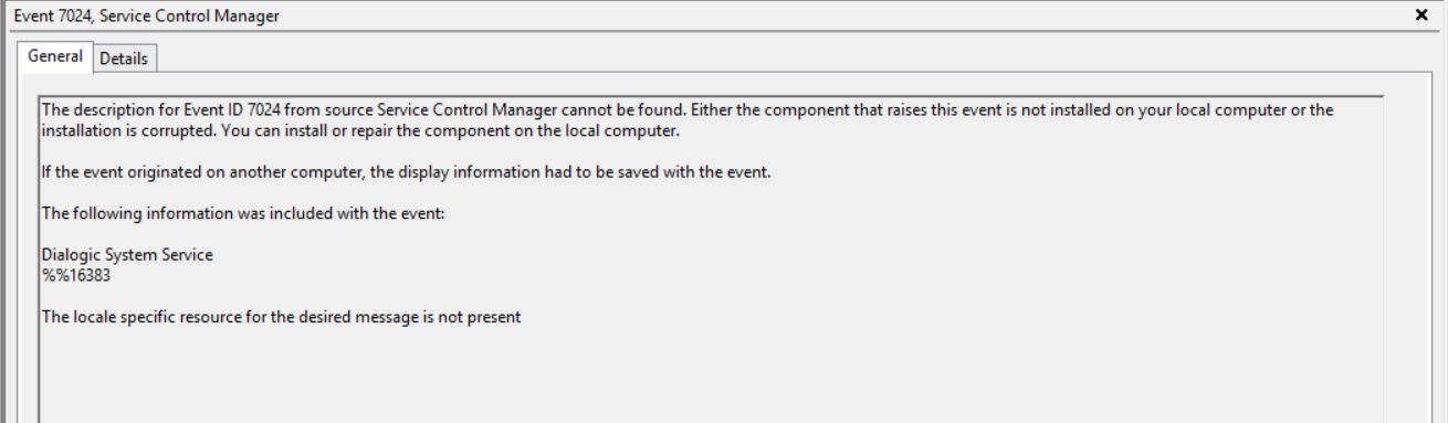

I am getting below error while trying to start the dialogic Manager also find the Ktts logs
0712_ktTts.txt
The Dialogic drivers need to work before you can try using VoiceGuide with them.
Suggest you try reinstalling the Dialogic drivers and see if they start ok after the reinstall.
