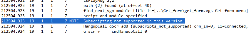

D.H. Report post Posted 07/24/2020 02:02 PM Hi Support, I found my voice guide suddenly cannot jump to subscripts, and after checking the log it seems saying my version does not support subscripting. Could you advise why? It was working fine when I use evaluation license. 0724_1424_vgEngine.zip Share this post Link to post
SupportTeam Report post Posted 07/24/2020 08:14 PM Trace shows that this system is licensed as a "Professional" version of VoiceGuide. Sub-scripting is a feature available in the "Enterprise" license. Please see: https://www.voiceguide.com/ivr-software/ivr-system-features.htm Share this post Link to post
