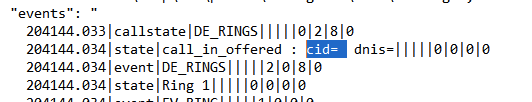

Hi Support,
seems the caller_id was not captured in the VoiceGuide, as in the call log, the cid is empty. Also, try to use the $RV_CIDNUMBER / $RV_DNIS variable, but both are empty too. could you advise?
This system is using analog lines.

If the CallerID is being sent on the line then you will be able to see it being detected and reported by the Dialogic card in both the ktTel and vgEngine traces, and then accessible using the $RV_CIDNUMBER variable. This is done automatically be default and no special script/setting is required to enable this.
Please post VoiceGuide's ktTel and vgEngine traces that capture system startup and the incoming call and we will then be able to see what is happening on the system and advise.
Dialogic trace shows that the Dialogic card did not detect any CallerID data sent by the telephone company.

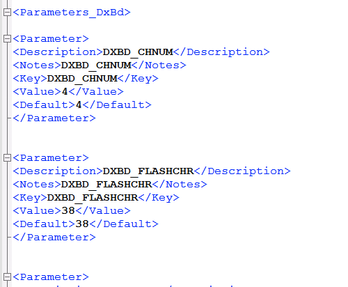

Similarly, the DXBD_ 'board settings' for the Dialogic board can be specified in the Config.xml file.

For the parameters, we try to put them to the "configline.xml" like you mentioned, for "DXBD" we tried to put into "<Parms>", "<Parameters>", "<Parameters_DXBD>" and "<Parameters_DxBd>", but still cannot get the callerid. Could you check and advise?

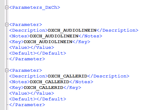

Pleas add the below entry into the ConfigLine's "<Parameters_DxCh>" section. Looks like this entry is missing from your current ConfigLine.xml
Note that the Key to use is: "DXCH_CALLID",  not: "DXCH_CALLERID". "DXCH_CALLERID" is not a valid Dialogic DXCH_ parameter name.

The above DXCH_CALLID entry is in the default ConfigLine.xml file installed on system when VoiceGuide is installed for Analog systems.
Looking at your vgEngine trace we can see that your current ConfigLine.xml file only has an entry for one Disconnct tone, and only for DXCH_RECRDRATE and DXCH_PLAYDRATE parameters:
