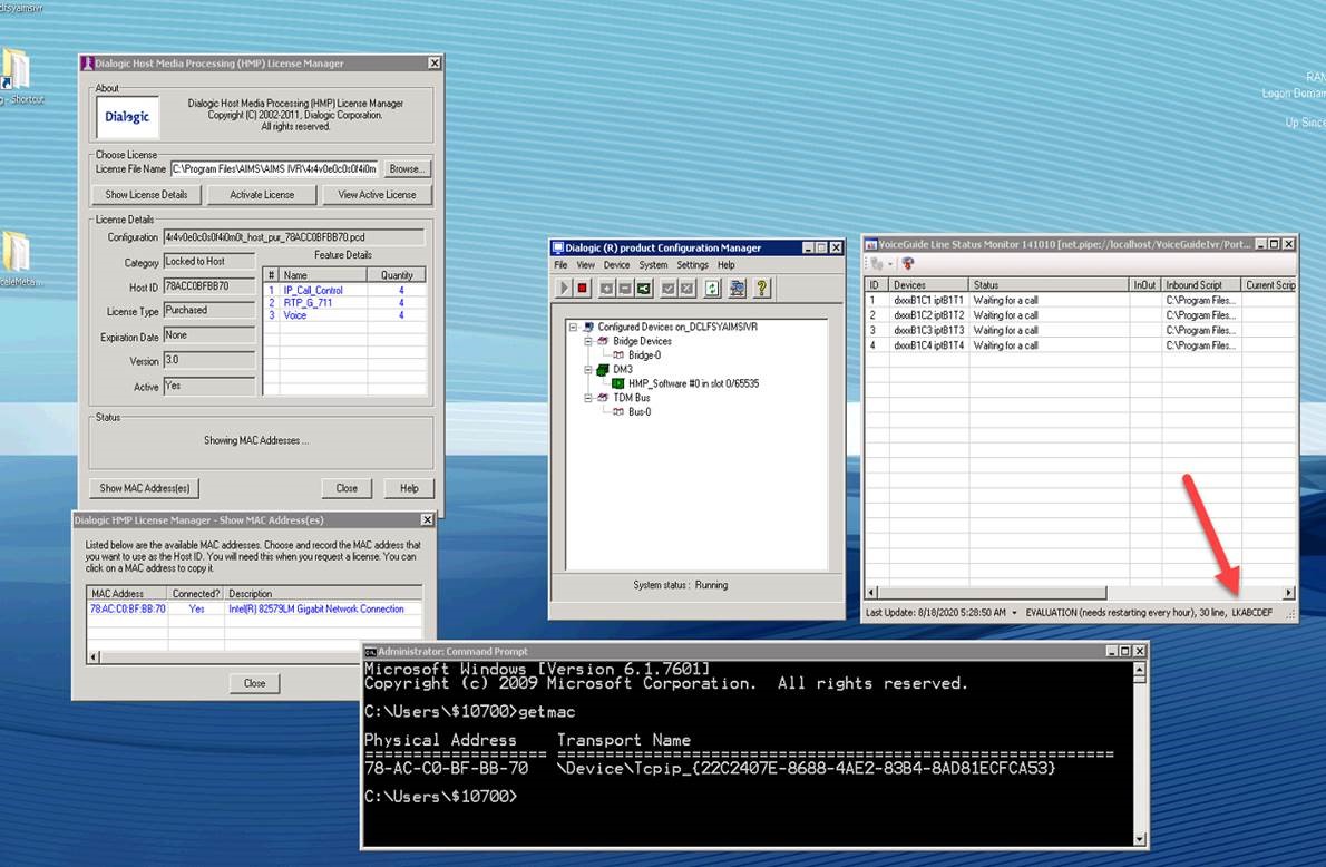

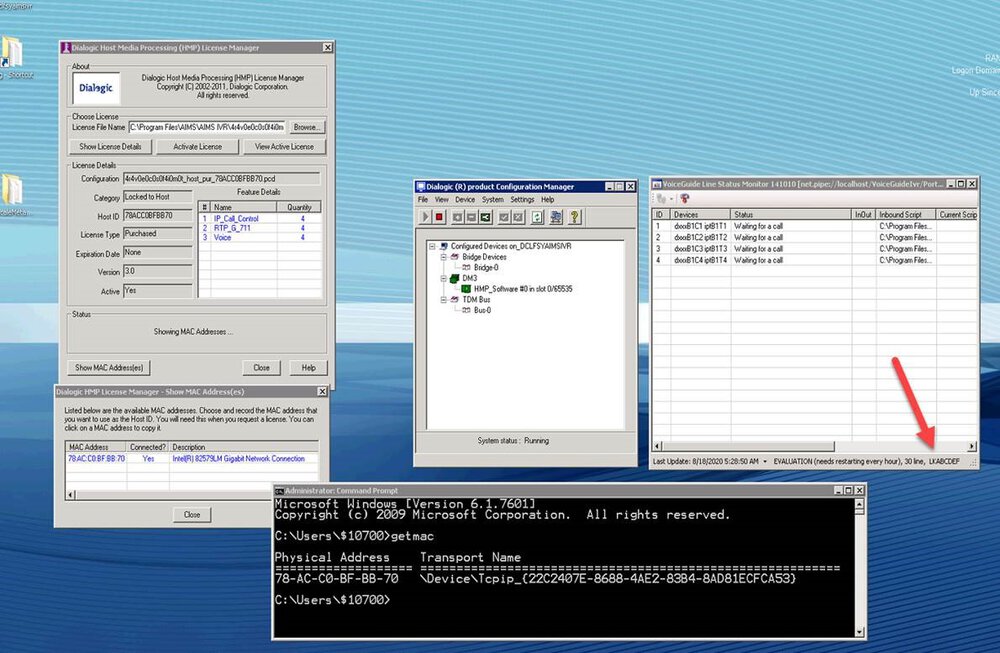

lucasklos Report post Posted 08/18/2020 10:33 AM Hello, We are having some problems with one of our installations (running Voiceguide 7.4 + HMP). It seems that the Unique Id changed and the license is not recognized anymore. Please see attached logs. I'm also attaching an image where you can see the hmp license and mac address. Thanks! 0706_1115_vgEngine.txt 0706_ktTel.txt 0707_0824_vgEngine.txt 0707_ktTel.txt Share this post Link to post
SupportTeam Report post Posted 08/18/2020 05:24 PM The "LKABCDEF" ID suggests that the Dialogic service did not start correctly. Please manually stop the VoiceGuide service and the Dialogic services, then start the Dialogic service, and once it's startup has completed then start the VoiceGuide service. Share this post Link to post

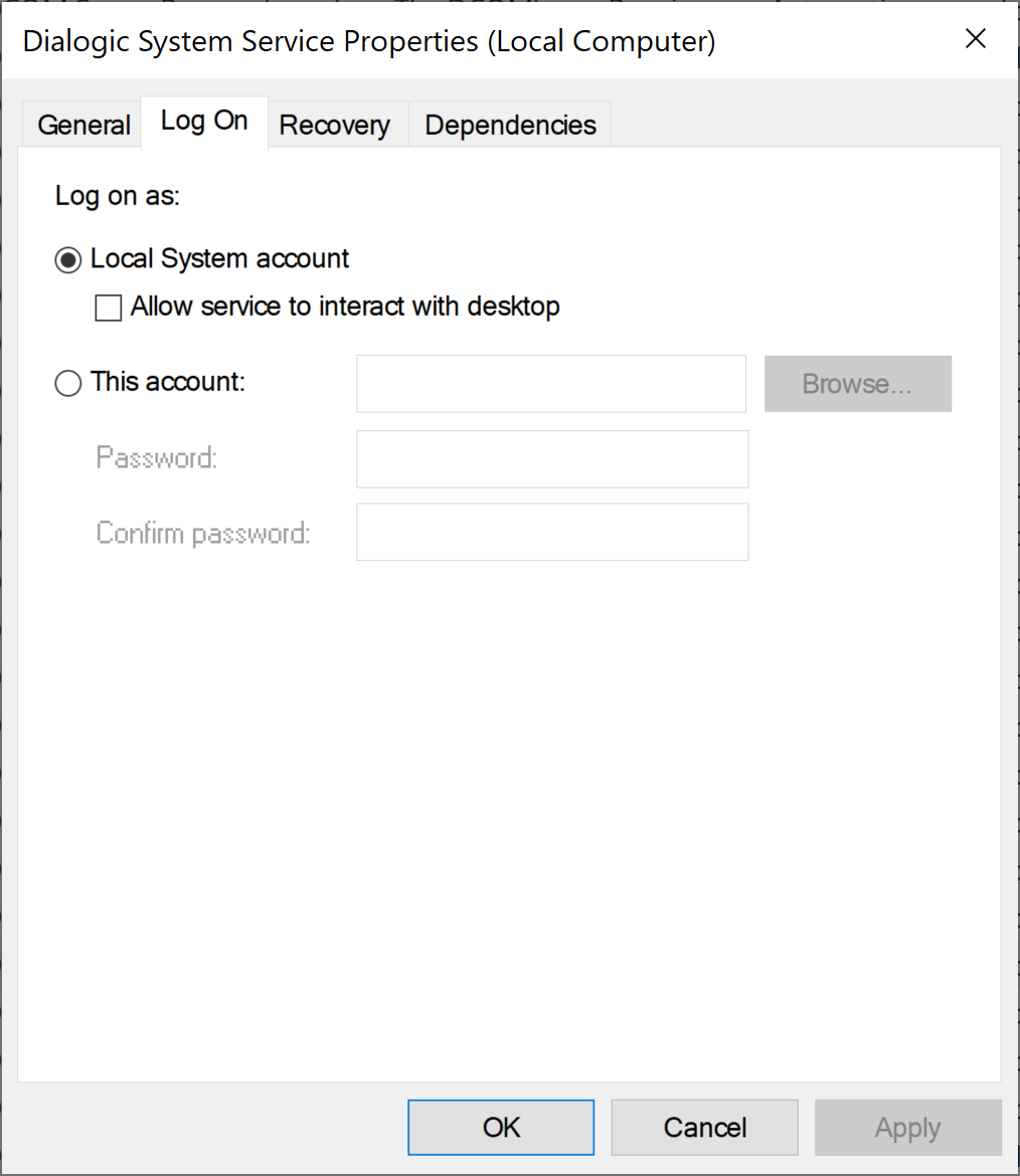

SupportTeam Report post Posted 08/20/2020 08:17 PM The service to check is the "Dialogic System Service". Make sure that it is still started under a "Local System" account. Here is a screenshot of relevant Properties page: Has anything changed on this system at around the time this started occurring? Was anything installed or updated? eg: a different version of network drivers installed? The issue here is that the Dialogic drivers cannot read information from the network interface. If you cannot identify what system change was done at the time when this issue started occurring then the the next course of action would be to reformat the hard disk and re-install Windows and the Dialogic drivers + VoiceGuide. Share this post Link to post
