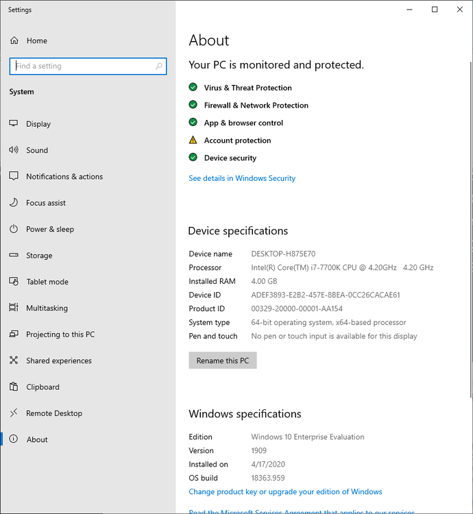

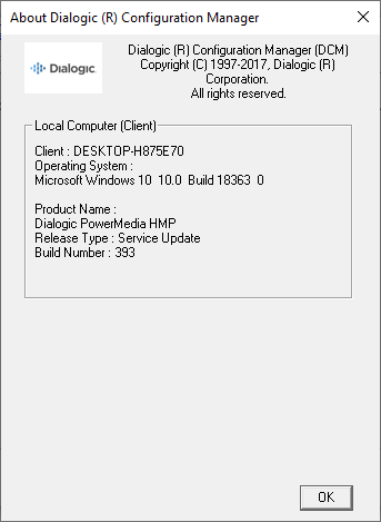

We tested the latest version of VoiceGuide on the same build version of Windows (18363) and both HMP and VoiceGuide started OK with no issues.
Screenshots and traces attached.

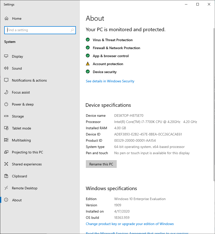

We applied the latest outstanding Windows update to this system, and HMP and VoiceGuide still started fine. Both when starting the services manually, and when set to start automaticall on Windows startup.
Windows Update is now showing "You're up to date" message.
Traces attached below. The list of Windows updates installed on system is in the vgEngine trace file:
