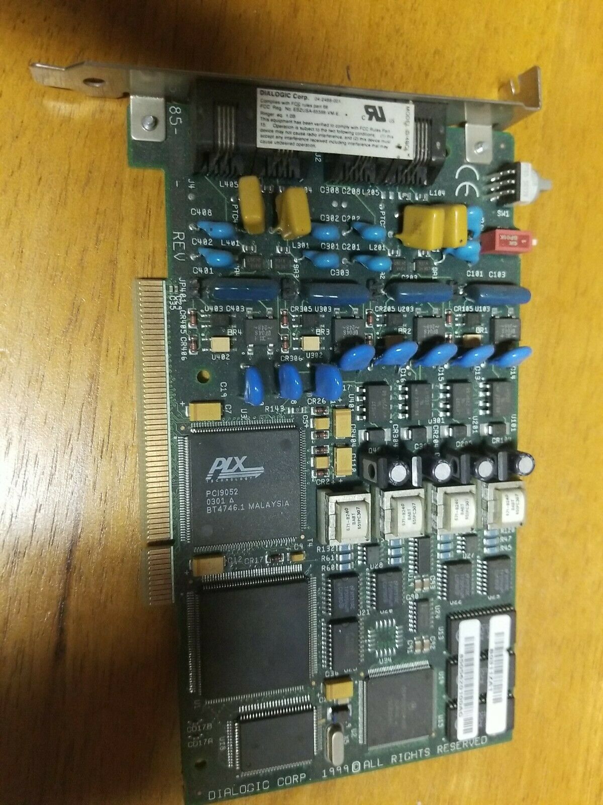

George G Report post Posted 10/30/2020 03:42 AM so https://www.ebay.com/itm/Dialogic-D4PCI-83-0562-003-Data-Board/133556201812?hash=item1f1891e954:g:wZUAAOSweIZflFUA will this be a replacement? Or I need that long specification to see? Share this post Link to post
SupportTeam Report post Posted 10/30/2020 04:07 AM That card (copying picture below) looks to be an old version made for a 5 Volt "PCI" bus only. This is not a "PCI-U" card. "PCI-U" cards can go into 5 Volt or 3.3 Volt PCI buses. Their bus adapter looks different (it has two notches in it) But if you are building a new system then you probably want to get a card made for a "PCIe" (PCI Express) bus. Share this post Link to post
George G Report post Posted 10/30/2020 04:09 AM so https://www.ebay.com/itm/Dialogic-D4PCI-83-0562-003-Data-Board/133556201812?hash=item1f1891e954:g:wZUAAOSweIZflFUA will this be a replacement? Or I need that long specification to see? Share this post Link to post
SupportTeam Report post Posted 11/01/2020 07:26 AM The Ebay card is not a "PCI-U" card. So it is not a replacement for what you have. Best to pull out the current "PCI-U" card and see if it is a "3.3V PCI" bus or a "PCIe" bus version. Share this post Link to post
