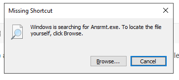

33ANGIE Report post Posted 02/10/2021 08:42 PM Hello, We are looking for the Dialogic's HMP Executable programs (.exe) and they are not saved after we have saved and uninstalled/installed the software multiple times. Is there anything that you can do to assist with this. I have checked program data and no .exe files were found. I have checked the Program files and no .exe files have been found. Share this post Link to post
