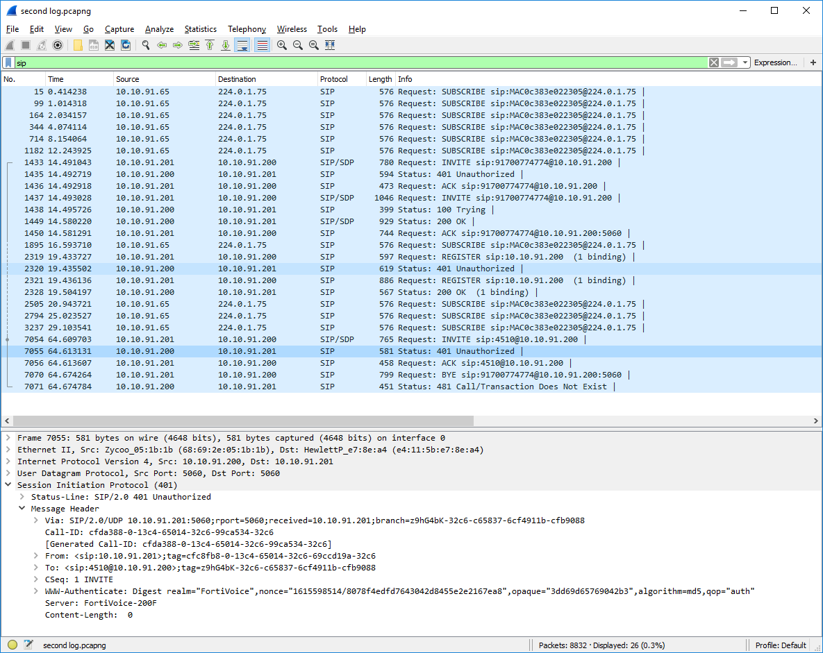

Fortivoice PBX at 10.10.91.200 responded to that call with a "401-Unauthorised". So looks like PBX is set to request authentication for calls arriving from the VoiceGuide system (10.10.91.201)
VoiceGuide's previous call to 91700774774@10.10.91.200 also responded to with a "401-Unauthorised", but on that call the "Caller-Id" / "From" was set to "4500@10.10.91.200", and  looks like the VoiceGuide system has the Authentication password configured for "4500", so call proceeded after authentication.
On the outgoing ACD call to agent the "Caller-Id" / "From" was not set, so when 401 response was received VoiceGuide did not know what registration data/password to use to authenticate, and the call was dropped.
So the solution is to either ensure that "Caller-Id" / "From" is set on the outgoing ACD calls, or that Fortivoice PBX accepts calls from 10.10.91.201 without authentication. (ie: Fortivoice  uses "IP based" authentication).
