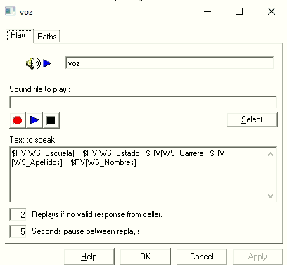

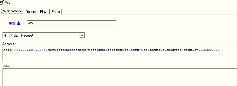

dminof Report post Posted 03/19/2021 07:20 PM Hello, what would be the correct $RV to use to bring the query results to WS Greetings Thanks 0319_1409_vgEngine - copia.txt Share this post Link to post

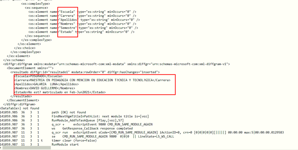

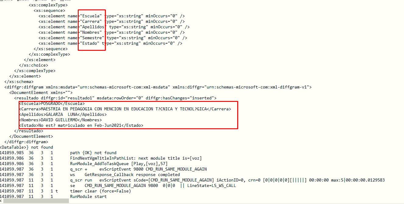

dminof Report post Posted 03/20/2021 03:02 PM Hi, I post the new log whit voiceguide 7.6 Br Diego 0320_0954_vgEngine.txt Share this post Link to post
SupportTeam Report post Posted 03/20/2021 10:58 PM In VoiceGuide v7.6 for this web service call you can use the following Result Variables to retrieve the required data: $RV[Escuela] $RV[Carrera] $RV[Apellidos] $RV[Nombres] $RV[Estado] Share this post Link to post
