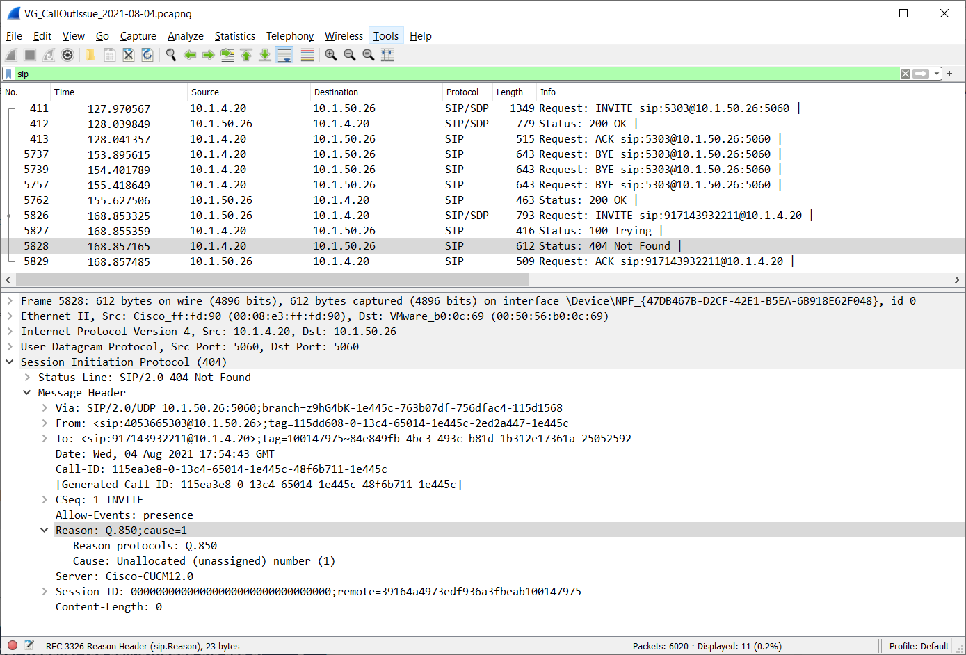

Wireshark shows VG sends out the request but there is no response from SIP trunk.

WireShark trace shows the Cisco-CUCM12.0 device providing the SIP trunk to VoiceGuide is actually responding.
It is responding with a "100 Trying" and then with a "404 Not Found". And VoiceGuide then ends the call with a "DISCONNECTED" after it receives the "404 Not Found".
You will need to ask the administrator of the Cisco-CUCM12.0 device as to why it responded with a "404 Not Found" to the call attempt.
In the "404 Not Found" reply the Cisco-CUCM12.0 set the Q850 Cause Code to "1". ie: "Cause: Unallocated (unassigned) number (1)"
So looks like Cisco-CUCM12.0's did not know how to route that call...
