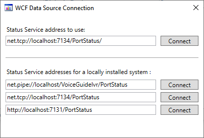

Have you tried using any of the the default settings for the Line Status Monitor. Click on the "Source" button on the Line Status Monitor:
and select one of the 'addresses for a locally installed system' :
note how "localhost' is used in address for connecting to VoiceGuide server running on same system.
