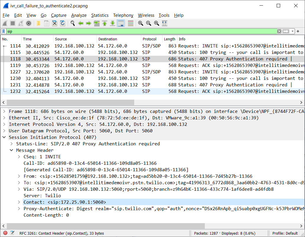

Hello
Twilio does not support registration. We are able to make inbound calls to the server just fine. Here is a capture of an an attempted outbound call to +15628653907

Hello
I redid the capture, starting with the starting of the VG service and ending with the failed authentication on an outbound call.  I called 15628653907.  Note: On the previous capture I may have called number ending in 3344.

Can you also please post VoiceGuide's ktTel trace that captures system startup and the outgoing call attempts. Please .ZIP up the trace before posting.
15628653907 call:
15628653344 call:
