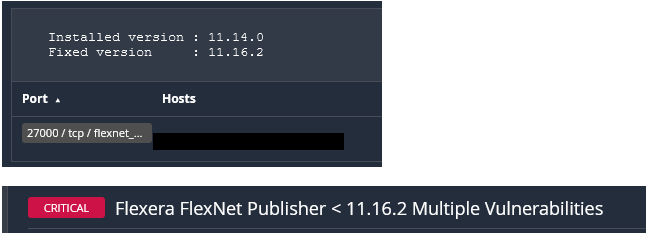

Hello Support team,
We got a question from one of our customers today that they have detected Security Vulnerability issues on "Flexera FlexNet Publisher" on IVR Server, which is part of HMP Driver.
This is something we didn't realize that it was a part of HMP Driver, and could not find out any interface or software that shows from HMP software.
Do you know how we can check the version of "Fixera FlexNet" from HMP driver, and if the current HMP driver (from your download link) will resolve this? (The version should be 11.16.2 or higher)
Thanks in advance.
