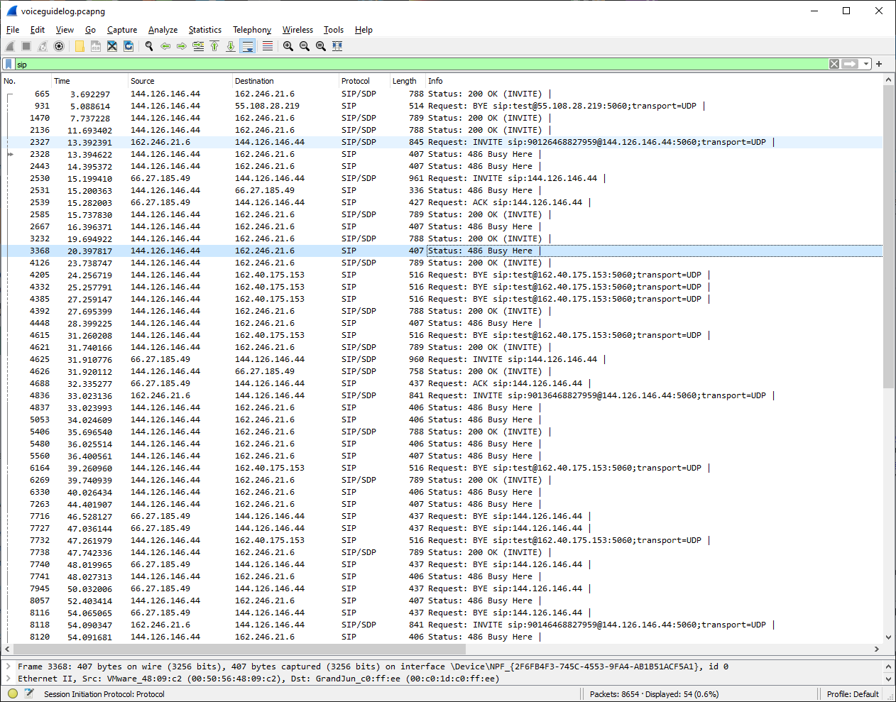

here are the logs
voiceguide ktel log.txt
voiceguidelog.pcapng
VoiceGuide ktTel and WireShark traces show a number of calls made into the system and answered by VoiceGuide.
The system is running in a single line evaluation mode, so calls made while there is already an active call on the system are rejected.
On the calls that were answered no keypress/touchpad events were detected.

This will allow for confirmation of whether the voice RTP connection is working in both directions and if the keypress actions are being transmitted.
