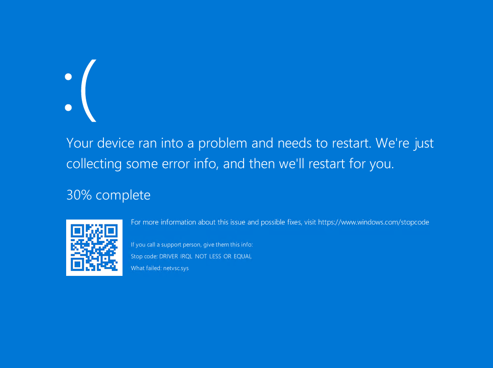

Blue screen error: IRQL NOTE LESS OR EQUAL
We obtained the latest version of Voiceguide Voip and the latest version of Dialogic HMP from your download page and installed them on a fresh install of Windows 10 Pro 64-bit.
We are testing with a 1-port license.
Every time a call comes into the IVR it works for a few seconds but then we get this blue screen error:
Windows has all the latest updates installed.
Voiceguide has only the default settings and script on the default 1-port setup.
Logs attached.

Traces show that you are running this Win10 system on a Hyper-V virtual machine.
We recommend using a Server category Windows OS to run VoiceGuide, and on a dedicated machine, or in a VMware virtual machine.
To test on Hyper-V you can use the previsions version of HMP - the one that is listed on our Downloads page for use with "Windows: 2008, 8.1Pro, 7 SP1" (HMP Service Update 393)
HMP Service Update 393 supports Windows 10 (and Win2016 and Win2019)
To change HMP versions you need to fully uninstall previous version of HMP and restart Windows before installing new HMP version. Do not save any configuration when uninstalling.

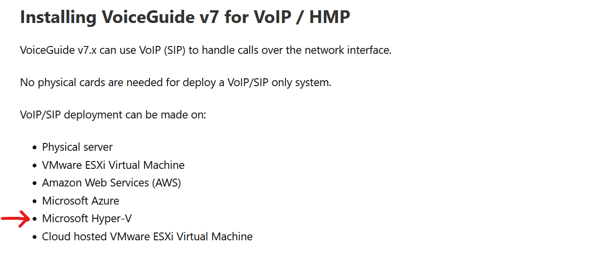

Your site over here says clearly that Hyper-V deployments are supported and makes no mention of it being not-recommended.
See below:

So because of this we have been trying to steer users away from Hyper-V, and instead have users deploy on platforms that can run latest HMP.
But at the same time Hyper-V is still included in list of supported systems - because it works, although with the 'must use older HMP' caveat...
So hopefully the above explains why Hyper-V support is considered a bit of grey area right now.
