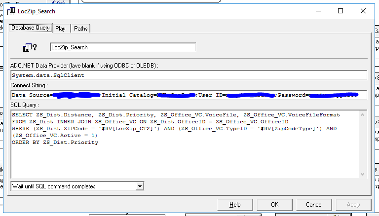

I have issue to use database query module. The error that I can find from script log is "An OLE DB Provider was not specified in the ConnectionString.  An example would be, 'Provider=SQLOLEDB;'".
I did try to add "Provider=SQLOLEDB;'" before Data Source, but it didn't fix the issue.

230358.095  20   8   2     2       db    did not find ado.net data provider : [System.data.SqlClient]
Perhaps the ADO.NET data provider matching is case sensitive ?
Please try using:
System.Data.SqlClient
as your specified ADO.NET data provider. Note that the middle word of the above "System.Data.SqlClient" is "Data" with a capital "D", not "data" with a lowercase "d".
