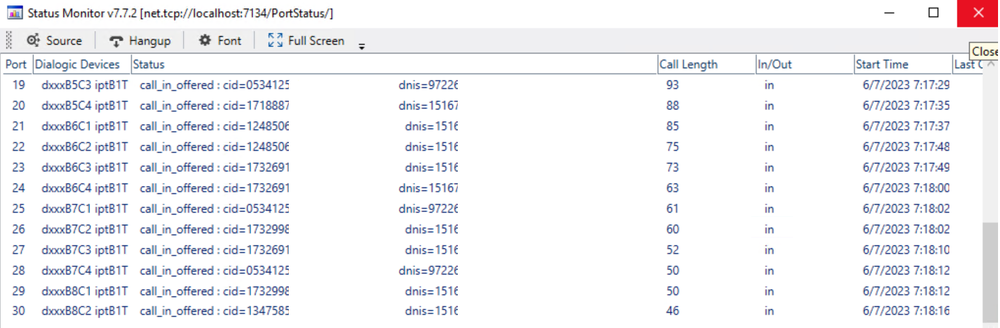

Inbound calls not answered. "call_in_offered"
For months everything was working perfectly.
Suddenly today we find that VoiceGuide is not answering inbound calls.
We have not many any changes recently.
Line status monitor shows Status of "call_in_offered" as shown.
Note that the same inbound phone call is occupying multiple lines.
The caller hears ringing.
We restarted the machine but the problem persists.
We switched to defaultinstall files for vg.ini and configline.xml but the problem persists.
Please advise how to fix this.
