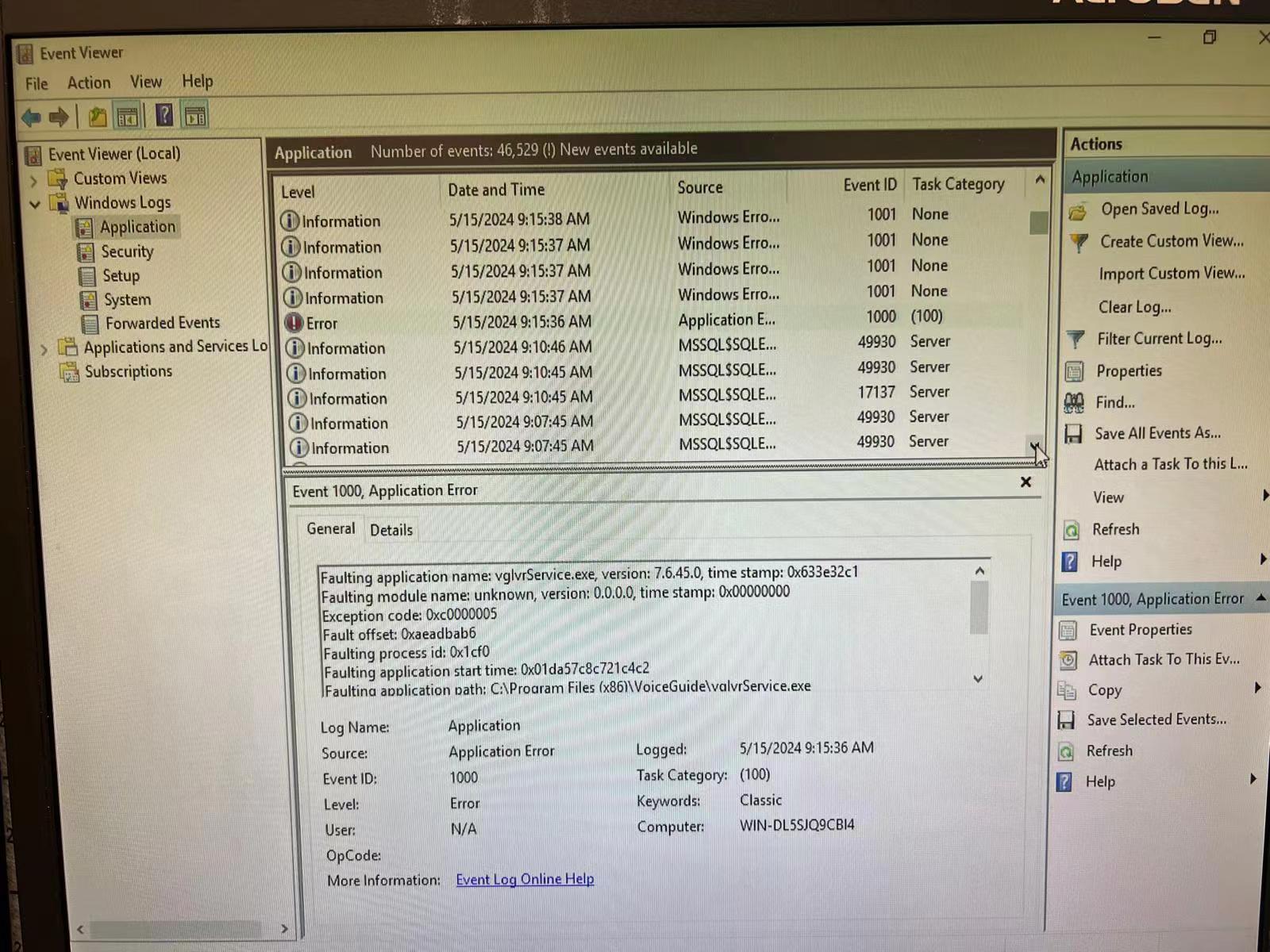

Our customer's Voiceguide system stopped suddenly yesterday,, 15.5 the Windows event log shows error of attached image.
This issue rarely happens. Time shown in the screen capture of Windows event log is HK local Time. We checked the Voiceguide's ...vgEngine.txt log of 15.5, see nothing special, time in the vgEngine.txt are GMT time

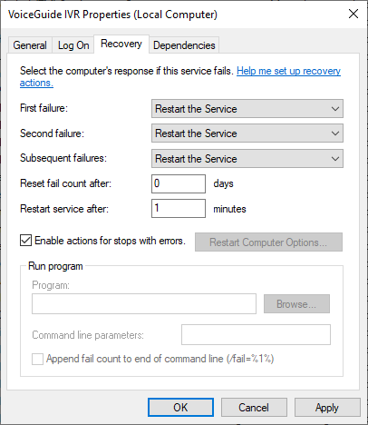

If you do not want to remove your Kaspersky Anti-Virus then you can just set the VoiceGuide IVR Service to automatically restart. You mention that you see this issue rarely (once a year or so?), so just setting it to restart automatically may be an adequate way to handle this in your case.
In the Windows Services Control Manager window, right-click on the "VoiceGuide IVR" service entry, and then from the popped up context menu select "Properties".
The Properties dialog will pop up, and on that dialog click the "Recovery" tab.
Then select the "Restart the Service" option for the "First failure", "Second failure", and "Subsequent failures" options.
See screenshot below:
