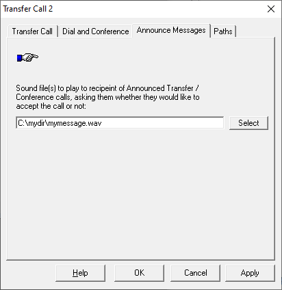

Using the call transfer module options, I want to use an announcement for the receiving party before connecting the call. Is it possible to use TTS (Text-to-Speech) or something like a prompt for the recipient in the "announce message"?
The announcement for the recipient needs to be variable, with information coming from the CRM.
The 'Announce Message' to play to the receiving party is set on the "Announce Message" tab of the 'Transfer Call' module's 'Property Dialog'. Please see the screenshot below:
The announce message is played on both the "Monitored" and "Announced" transfer types.
On the "Announced" transfer types the call recipient can accept the call or decline the call, and on the "Monitored" transfer types the call recipient is just played the announce message before the call is automatically connected.
