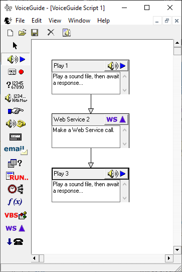

Given that you want to first play a sound file and get some keypress from the caller first then you will need to first use a "Play" module, and then after getting the keypress then goto a "Web Service" module... and then when the Web Service module returns then you can use another Play module to play out the Result Variables set by the Web Service module.
The general approach would be something like this:

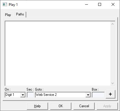

To have the callflow go from module "Play 1" to module "Web Service 2" when key "1" is pressed:
  1. Create a new .vgs callflow
  2. Create a Play type module. Lets say it's title is "Play 1"
  3. Create a Web Service type module. Lets say it's title is "Web Service 2"
  4. Open the module "Play 1" Properties page.
  5. Select "Digit 1" in the bottom left drop-down box (the "On:" selection),
  6. Select the "Web Service 2" module name in the second drop-down box (the "Goto:" selection),
  7. Press the "+" button to add the path.
  8. Save the .vgs callflow.
Screenshot with "Digit 1" and "Web Service 2" selected int he dropdown boxes.

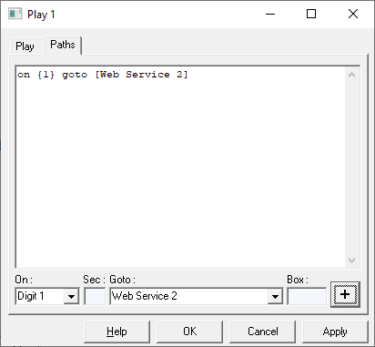

and after pressing the "+" button you will see the path listed in the "Paths" tab:
click "OK" to save and you will see the path arrow on the callflow screen.
nb: You can also just type the path direct into to main text box on the "Paths" property tab.
