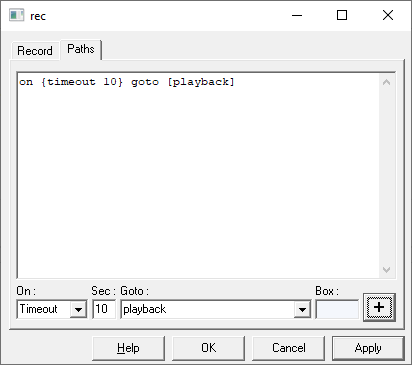

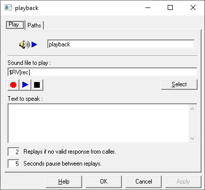

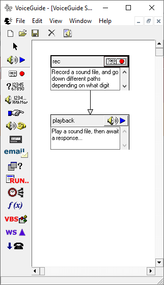

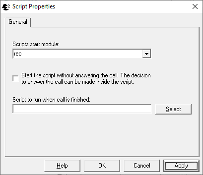

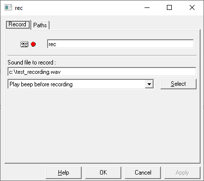

To test the sound quality of the voice path both ways, you can create a simple callflow script that just records the callers voice for, say, 10 seconds and then plays the recorded sound back to them.
eg:
