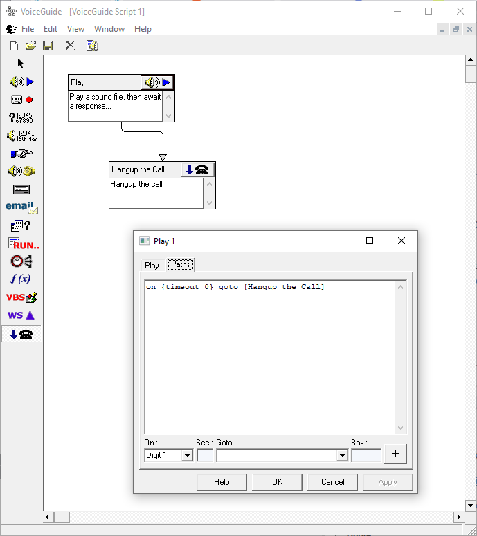

To end call immediately you just create a 'timeout 0' path to a Hangup type module.
Please see: https://www.voiceguide.com/vghelp/source/html/modhangupcall.htm
and from: https://www.voiceguide.com/vghelp/source/html/paths.htm :
Timeout Paths
A Timeout path will be taken if a caller has not made a selection within the specified number of seconds. A Timeout path with a wait time of zero seconds will be taken immediately after the last sound file in the module has completed playing.
