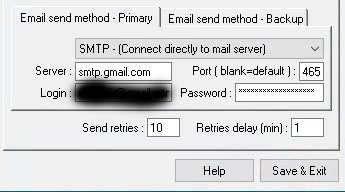

Our default email on this machine was not set-up.  Didn't know that mattered, but I've changed it to Outlook, which is configured for SMTP.  Still the emails are not going out.  Log attached.  I also removed the test.bat path so I can just focus on getting emails to work.  Also, I guess I'll just stick with port 465 since at least the test .vbs script work with it.

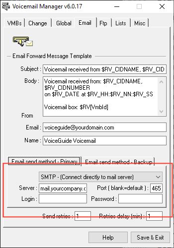

Looks like you are trying to set the system to send the email out using the 'MAPI' approach, but for some reason the MAPI functions in VoiceGuide return error when trying to connect to the specified MAPI server.
Recommend just using the SMTP method.
Please consult your email service provided for the correct server name / port / username / password to use with their SMTP server.

Sorry for being a newb, but I have it set to SMTP.  I tried changing it to MAPI then back, but still no emails.  Again, the VBS script using the same email credentials works.
Can you please post traces when the SMTP email send method is used.
