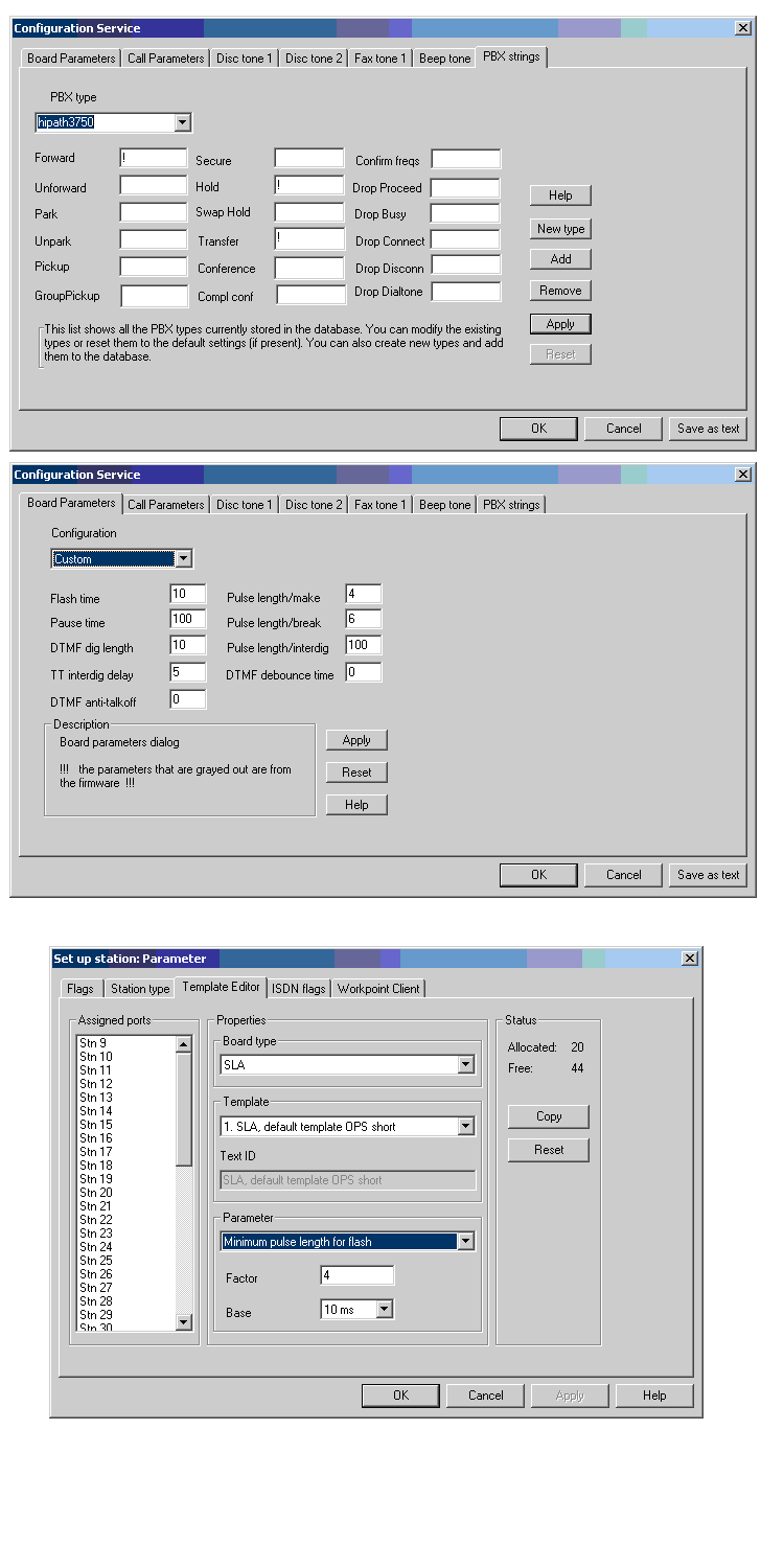

Guest lorer Report post Posted 05/06/2004 11:47 AM I reinstalled Dialogic's wav drivers. In Dialogic TSP I removed all default checks in the "PBX Strings" tab. It was like that with the other IVR-server (has two D/4PCIs) that runs on the same Siemens HiPath3750. Then in the "Board Params" tab I tried 10, 20,50 and 60 as "Flash time"s, none seems to work. With the other IVR-server the flash time is set to 10, and it can transfer calls fine. As mentioned before the O/S is Win2000Pro, and Dialogic is D/120JCT. Any ideas ?? == LEVENT == Share this post Link to post

Guest lorer Report post Posted 05/07/2004 11:20 AM OK. The foll did the trick: Apparently the Dialogic card was expecting a command for transferring the call which I added in Dialogic TSP's PBX Strings tab: Just exclamation marks "!" in Forward, Hold and Transfer boxes. Then checked the Flash Time in the Board Params tab to make sure the value (10) fell within the range specified in the settings for the PBX. The Siemens Hipath3750 was set to accept a "Minimum Pulse Rate For Flash" of 4 and a Maximum Pulse Rate For Flash of 12. Attached are the screenshots for the Dialogic TSP as well as for Hipath3750 Manager. Hope it helps somebody else among the VG users community. == LEVENT == scrnshts.zip Share this post Link to post
SupportTeam Report post Posted 05/08/2004 06:50 AM Thanks you for posting how the problem was resolved. Looks like you are now using "TAPI" to make the call transfers (please see the TransferControl_TelBoards setting in VG.INI file) which means that the Dialogic TSP needs to be told how to do the transfers (as you have done it). If you were using the "Generate" method then the settings from the "PBX Strings" would be used (see the Edit menu in the VG Script Designer). The screenshots that were included in .zip document are attached below for more convenient viewing. Share this post Link to post
