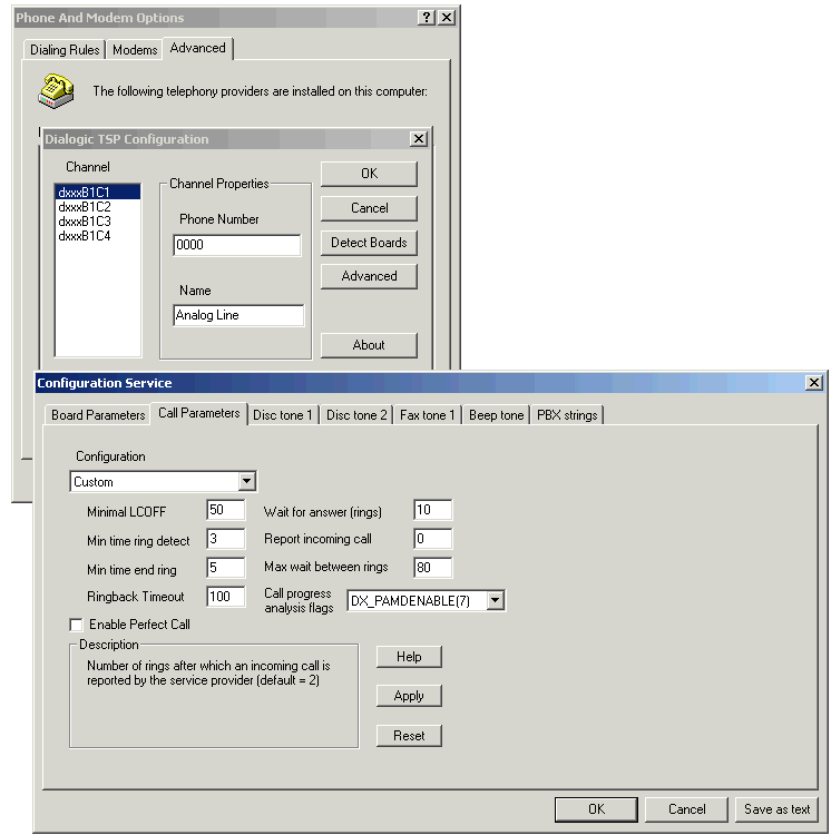

SupportTeam Report post Posted 06/06/2004 12:31 AM The Get Numbers as first module should work. Can you confirm that VoiceGuide is picking up the call immediately after the first ring? (you can do this by attaching a telephone handset in parallel with the line). If VoiceGuide is not picking up the call after first ring then you can try setting the "Report incoming call" configuration entry in the Dialogic TSP to 0 (see attached screenshot below). Share this post Link to post
Guest vknadagouda Report post Posted 06/07/2004 05:46 AM Changed the settings in Dialogic TSP for 'Report incoming call' to 0 as suggetsted, picked the call after the first ring, but no signs of callerid being received in the first module. help required urgently Share this post Link to post
