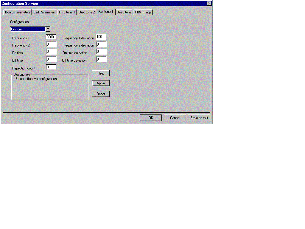

cmcma Report post Posted 06/16/2004 04:52 AM I cannot get the image to go through zippyimage.com Custom is selected in my setup Default Custom Freq 1 1100 2000 Freq 2 0 0 On time 50 0 Off time 300 0 Rep ct 1 0 Freq 1 dev 40 150 Freq 2 dev 0 0 on time dev 10 0 off time dev 10 0 Also, Would the call progress analysis flag field on the Call Parameters tab have any effect on this? Share this post Link to post
SupportTeam Report post Posted 06/16/2004 05:11 AM Can you just do screen capture, save it to a file and then post the file here please. Share this post Link to post
SupportTeam Report post Posted 06/16/2004 07:39 AM I notice that the Fax tone is set to a Custom setting - please select the 'Default' option and it should then work... Share this post Link to post
