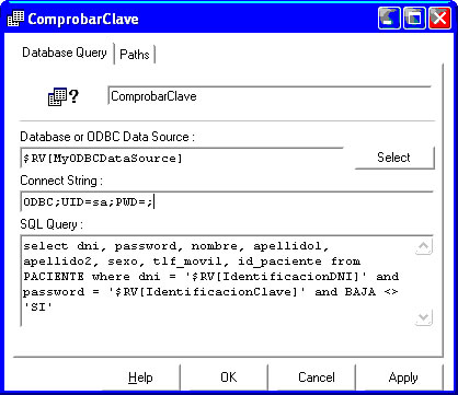

Hi! I have 2 enviroment database: deploy and production, can i use a variable in 'odbc data source' field in query node as screenshot?

Right. I am using vbscript to initialize ths variable depending some internal parameters. My doubt is just if i can use this variable where you can see in screenshot.

Sure you can, that's what the purpose of Result Variables is all about - being able to set them in one module for later use in another module... have you tried running this script yet?
No, i haven´t (i have a system in production...). I do not mean result variable, i mean to use a variable ($RV[]) in query node, in odbc datasource field, instead to use a constant odbc datasource.
