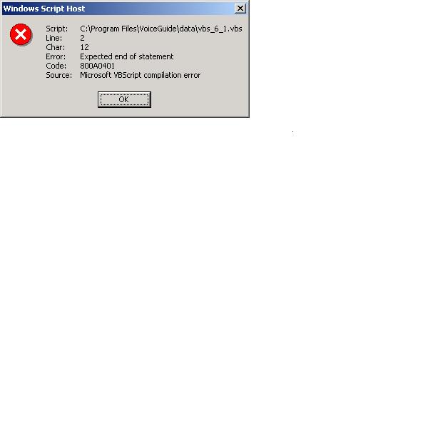

via VG script into the bellow VB script and run it? This VB script is located out of the VG script.
I am not sure how to use DDE, Run Program, or VB script module to poke the above date into the VB script. And I don’t have any VB programming experience. Any help would be appreciated. Thanks

Just run the VBScript from within a "Run VBScript" module, and then just use teh relevant Result Variables within the script...
Here is the log file when I run the previous VB script in VG file. also please see the error picture attached file that VG is displaying when VG module is runes.
Any suggestion I clear this error?

Looks like the error is right at the beginning of your VBScript - did you have a look at the line number mentioned in the error message and see what could be causing this error? You may want to ask a programmer who knows VBScript to take a look at it for you - they should be able to tell you where the error is.
If you are stuck please post the VoiceGuide script which produces this error and we can take a quick look at it for you.
I am stuck. thank you for helping me on this problem.
Please find my VG script attached. I have not enter the Result Variables into the VB script yet, because I don't know whether I have to input the result variable into the "params.txt" or into the VB script. Your advice on this part would be appreciated too.

The trace shows that the VBScript problem occurred in module [Run VB Script 1], yet the attached script does not even have a module with that name...
sorry, I have attached the worng file. Here is the file I use to transct the C/CNum to veisign.
the script is works well out of the VG script. but when I use it inside of the VG script it give me above error. since I have no exparince with VB programing, I don't have any idea how to resulve the error.
I realy faced wall, you are the only hope I have to fix this problem.
Edited by fsoudbakhsh
Looking at "TransactToVerisign" module I can see that you do not know how to program in VBScript.
I'd recommend speaking to a programmer to get this all sorted out for you.
