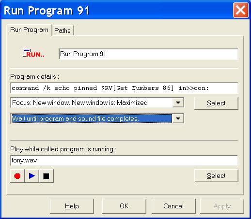

attached is the "Run program module" screen shot of one of the series of scripts
tested:
command /k echo $RV_ENTEREDNUMBER or
command /k echo $RV_ENTEREDNUMBER >>con: or
cmd /k echo $RV_ENTEREDNUMBER >>con: or ...
the expected functionality has not been achieved, namely:
the "Run progam module" should
1. "Wait until program and sound file completes."
2. "/k"eep the "command/cmd" running until "exit" is typed
and
3. "echo ..." some text on the command console
This does not happen, the module seems to be ignored.
Is there an activation or initialization sequence needed to invoke the processing of "Run program" modules? Can the above be done in a "Run program" module?

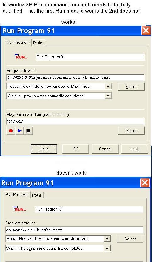

Run Program modules need command.com
to have a fully qualified path
ie.
"c:\windows\system32\command.com" will run
"command.com" will not
when specified as the program to run in a Run Program module.
in any case "cmd" is sufficient to invoke the XP command processor
note: also "cmd /c move ..." functions but "command /c move ..." does not
the XP design interface intentionally cripples the legacy support
and compatibity of previous OS conventions
