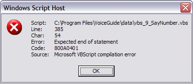

Just tried this on the system I have installed (Ver 5.2.4) and received an error. Could the line:
DateMMDDYYYY = "place" & mid(arg1,3,2) & ".wav, & "month" & Left(arg1,2).wav," & Number(right(arg1,4))
be incorrect?
Thanks!
The lib_num2wav.vbs which ships with v5.2.4 is correct and does not need to be changed.
The "Date - DDMMYYYY" function in lib_num2wav.vbs installed in v5.2.4 looks like this:
'name : Date - DDMMYYYY
'info : Say day, month, year
'arg1 : DDMMYYYY or DD/MM/YYYY:
Function DateMMDDYYYY(ByVal arg1)
  arg1 = replace(arg1, "/", "")
  If Len(arg1) < 8 Then
    Exit Function
  End If
  DateMMDDYYYY = "place" & Left(arg1,2) & ".wav,month" & mid(arg1,3,2) & ".wav," & Number(right(arg1,4))
End Function
