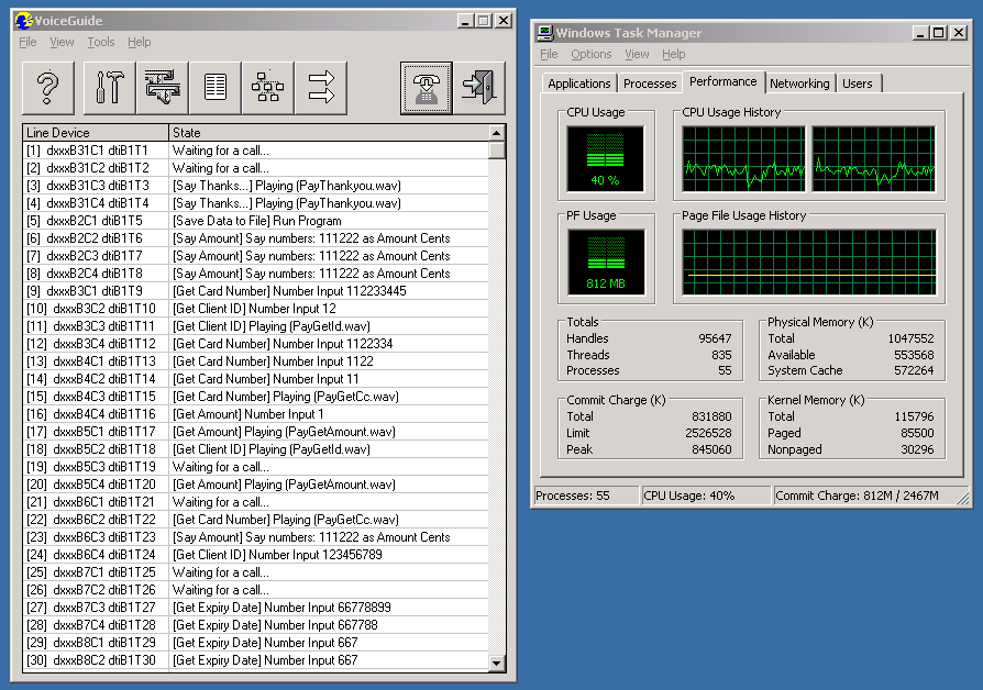

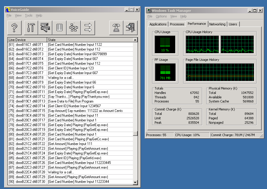

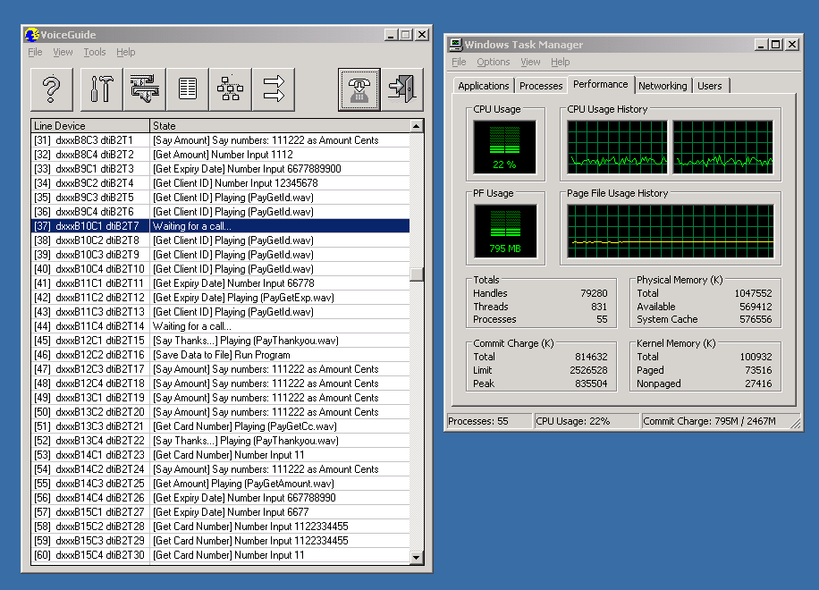

Here is what the system status is like with 30 lines going:
