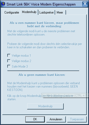

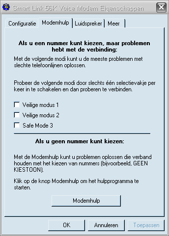

Guest Mart Report post Posted 11/06/2004 09:39 AM Hi, I think the hookflash works correct, but I notice, in the settings of my modem, there is nothing I can do when VG is activated. All the things you can select or set is gray and not to change. When I close VG everything is normal and selectable. So maybe VG is using the modem all the time when it's active. Is that depending of a setting?? Thanks in advance. Mart. Share this post Link to post
SupportTeam Report post Posted 11/06/2004 10:39 PM All the things you can select or set is gray and not to change What things are you talking about? Can you provide some sceenshots please. Share this post Link to post
Guest Mart Report post Posted 11/07/2004 11:27 AM This is with VG activated...(waiting for a call) Share this post Link to post
Guest Mart Report post Posted 11/07/2004 11:33 AM ...and this with VG CLOSED... Share this post Link to post
SupportTeam Report post Posted 11/07/2004 08:14 PM You should probably speak with the modem manufacturer to find out why their drivers work like this, and what significance this has. Share this post Link to post
