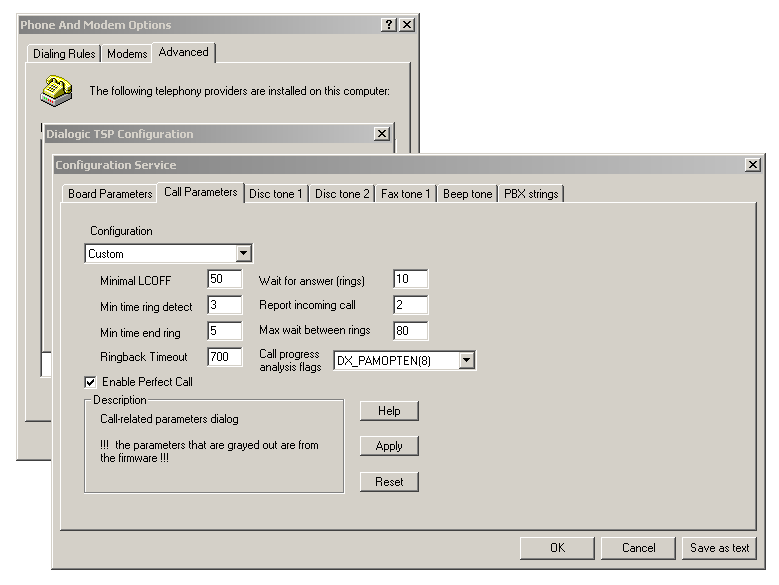

Maybe the time between ringbacks on the mobile line is so long that the Dialogic card thinks the call has been answered...?
Try increasing the Ringback Timeout parameter in the Dialogic TSP config:
Actually after looking into this further, changing the settings above probably will not affect the 'no ringback' timeout.

Sorry No luck. I've put the attacked file into the system32 and restared VG but same as before.
My TAPI setting is same as in your capture.
