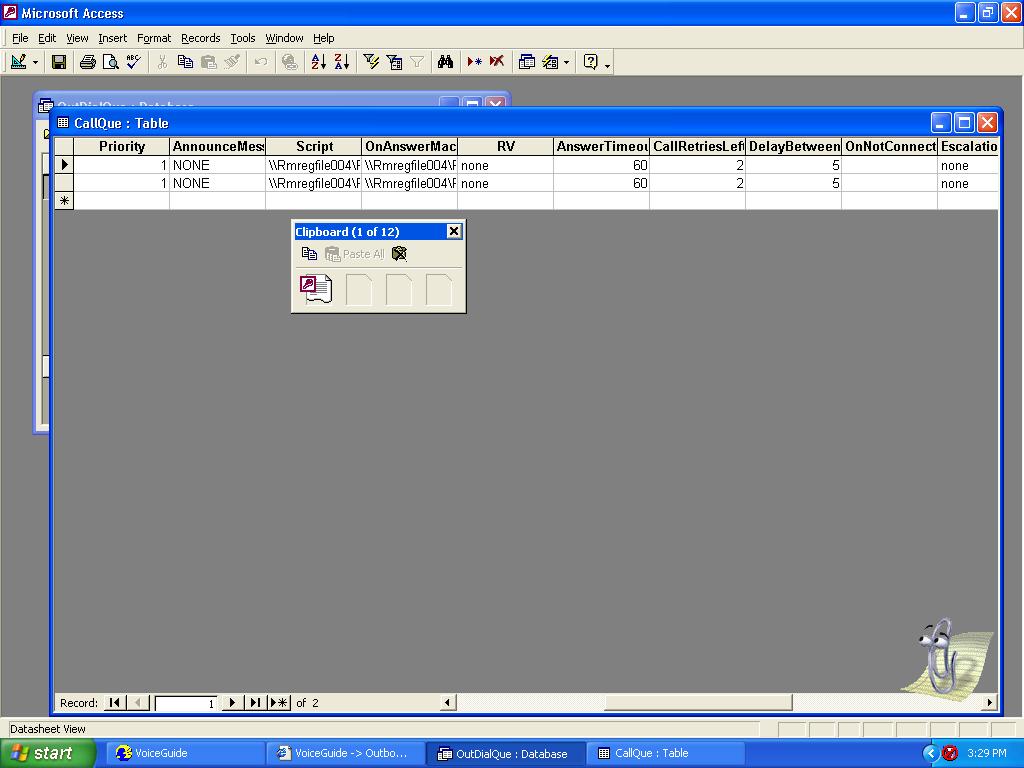

Here are the screen shots of the entries into OutDialQue.mdb.

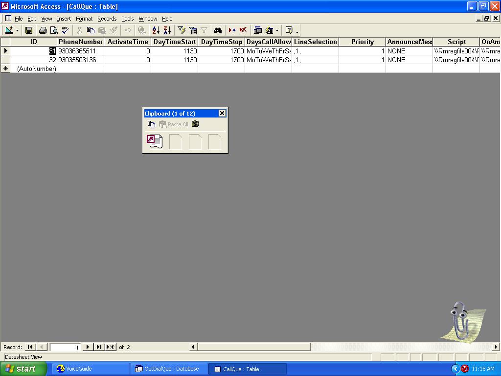

Can you please post more screenshots so that we can see all of the database fields...
One thing we can see here is that you have the LineSelection field populated with:
,1,
I'm not to sure if this would work for you as we don't know if the LineID of any of the telephony devices you have selected to use on the system is 1.
Can you try just placing the below in the LineSelection field:
(two commas side by side) and see if this makes the call go out on any of the lines.
