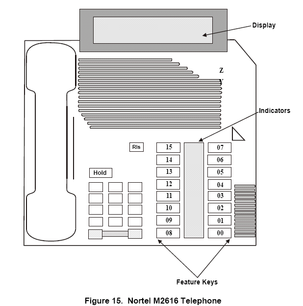

And here is what you would need to dial from within VoiceGuide to mimic the pressing of the various keys on the extensions attached to the Dialogic card:
Feature Key 00 : $KA
Feature Key 01 : $KB
Feature Key 02 : $KC
Feature Key 03 - Transfer : $KD
Feature Key 04 : $KE
Feature Key 05 : $KF
Feature Key 06 : $KG
Feature Key 07 - Program : $KH
Feature Key 08 : $KI
Feature Key 09 : $KJ
Feature Key 10 : $KK
Feature Key 11 : $KL
Feature Key 12 : $KM
Feature Key 13 : $KN
Feature Key 14 : $KO
Feature Key 15 : $KP
